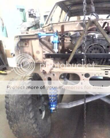

Here's a little background story: I bought the Cherokee and never had the time to do what I wanted with it so I gave it to my dad. He wanted to put it on 1 ton axles up until I bought my Prerunner and he thought it was cool. So the plan changed again and we took it to Lenger Racing (where my ranger came from), it's getting custom twin I-beams and radius arms up front as well as rear four link. It's behind schedule so Ryan (owner of Lenger Racing) is going all out this week and he is delivering it across the state to us Saturday
Basics are:
King remote resi coilovers front and rear
600 HP 7500RPM small block
2 speed powerglide
Ford 9" with 4.56s and a spool
33" General Grabbers
18-20" of travel up front
24-26" of travel in the rear
Corbeau seats
Full cage of course

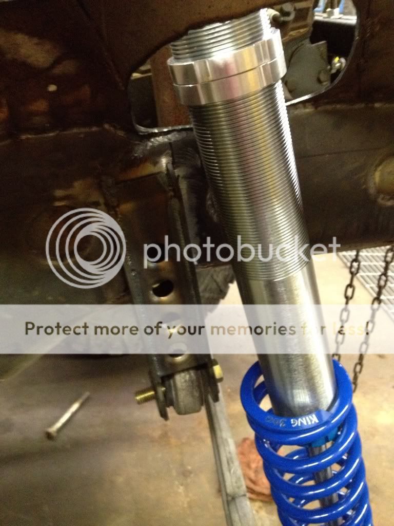

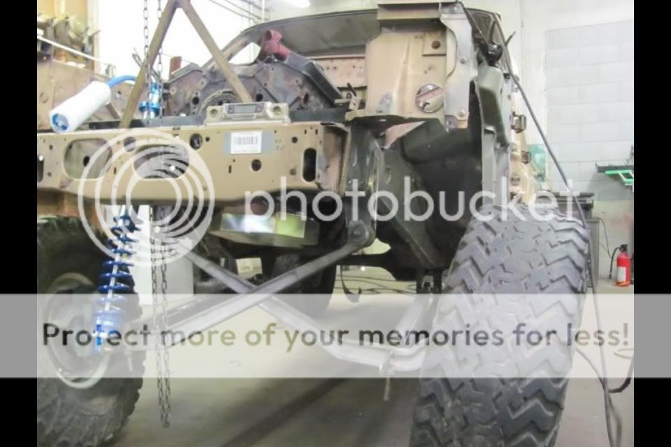

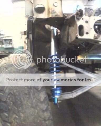

Here's some pics of the progress:

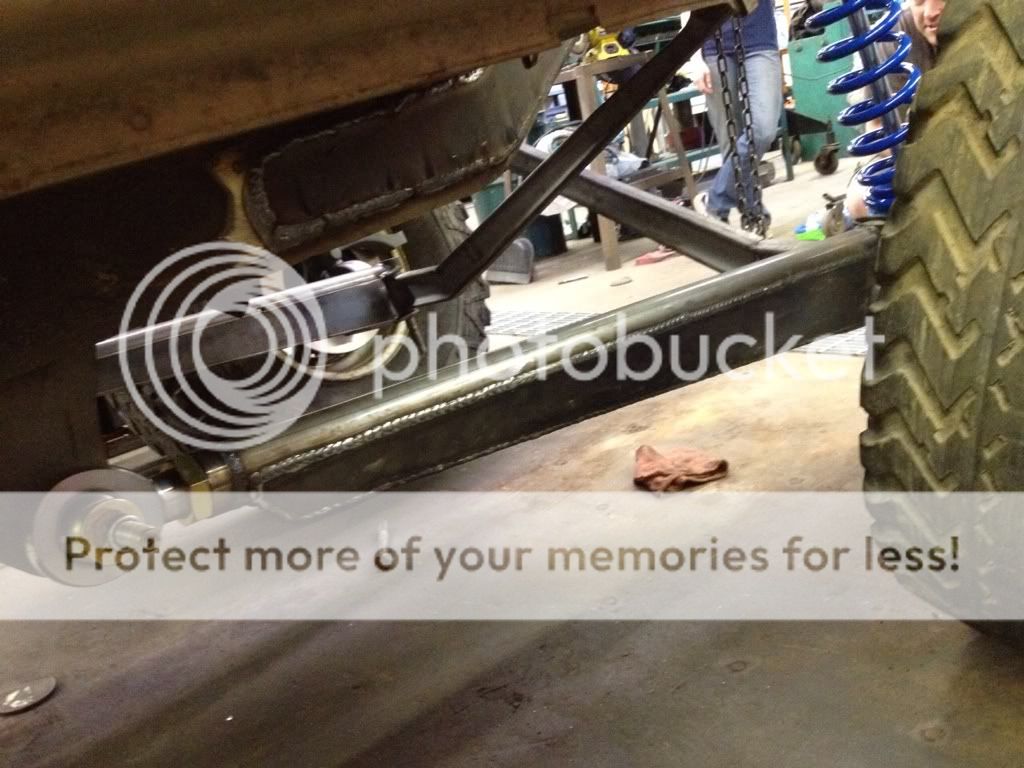

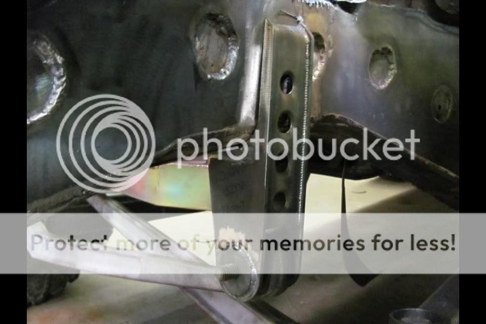

Close up of the beam mounts.
Travel.

I sure hope the radius arm mounts aren't done, single shear = Death
I hope we remember to mount the drivers side coil over too. That would be real bad. Lol these are progress pics. It will obviously be double shear

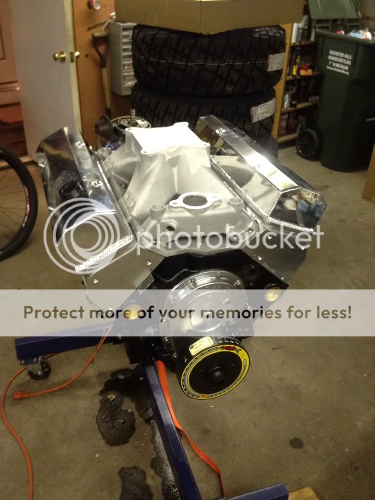

I like what I'm seeinf so far. That's a pretty fancy looking oil pan, what motor is that?

The motor is a small block Chevy. The pan is baffled and larger capacity. The motor seen in the pic is just for mock up along with the power glide trans. I'll see if I have a pic of the engine in my garage.

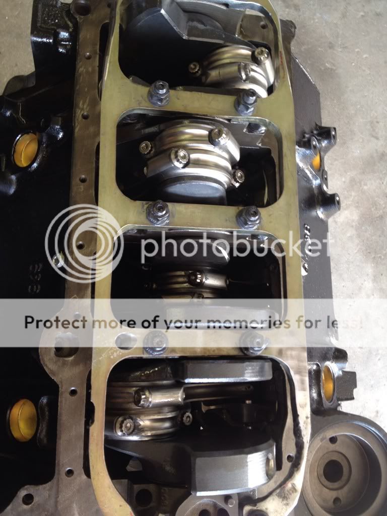

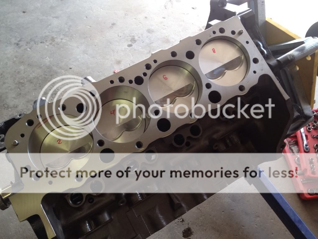

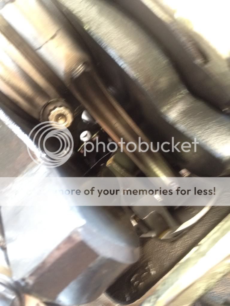

Here's some engine pics I had.
Everything was balanced to 8000RPM. He's going to "play it safe" and limit it at 7500 hahah I honestly can't wait it's going to be ridiculous.
