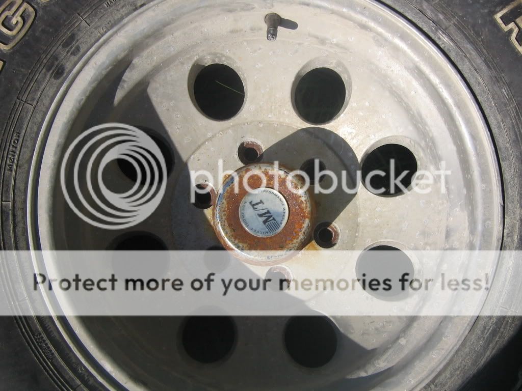

What is the best way to clean these? I just picked up a set at a swap meet and there is a little oxidation getting started on them them. Does the Mother's Powerball work well for this kind of thing? The recesses are painted black, so I wouldn't have to do anything with that, just the face and around the rivots.
Also what is the best way to protect them from further oxidation? They are plain machined "Ultra" brand wheels with no clearcoat.

I rinsed them off, and hit them with Mother's and Neverdull. I made a world of improvement, but the stupid rivots are a pain, my fingers are plain and simple too big.
Right before, left after.

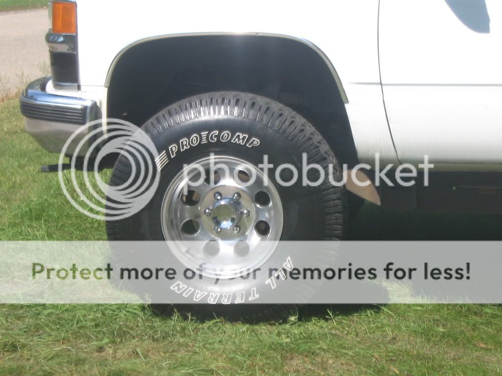

Mothers powerball works wonders! My room mate used in on his rims and I was sold!
(sorry for the big pics, they're his not mine)
Quote SBCYJ (from another forum, I'm just copying it)
"Mothers power ball, mothers alum. polish, and steel wool. took me about an hr. per rim"
BEFORE:
Machined Aluminum Rims
AFTER:
