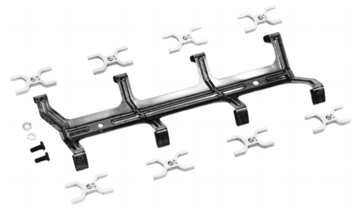

As far as what you need to put the cam in, I'm not positive. But you will need keepers for the roller lifters. There are a few different kits available that I've seen.
EDIT: It will look like this:
