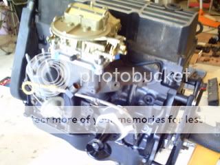

I started out with a 2.0 out of a Ranger- that's how I got here. I wound up with a 2.3 from a '87 Mustang turbo engine sans the turbo. I had the block bored .030 over and new pistons and any necessary machine work is already done and I assembled the block. We got the head on this weekend- it is freshly built, too. I have a OMC intake with a summit Racing adapter and a Holley 350 to help it breath. I also have an Esslinger adapter kit for my late model bus transmission. Shorty header.

So I'll bring you up to speed with some pics and commentary. Pleas chime in with any suggestions.

The adapter-
Is this a shorty header?
