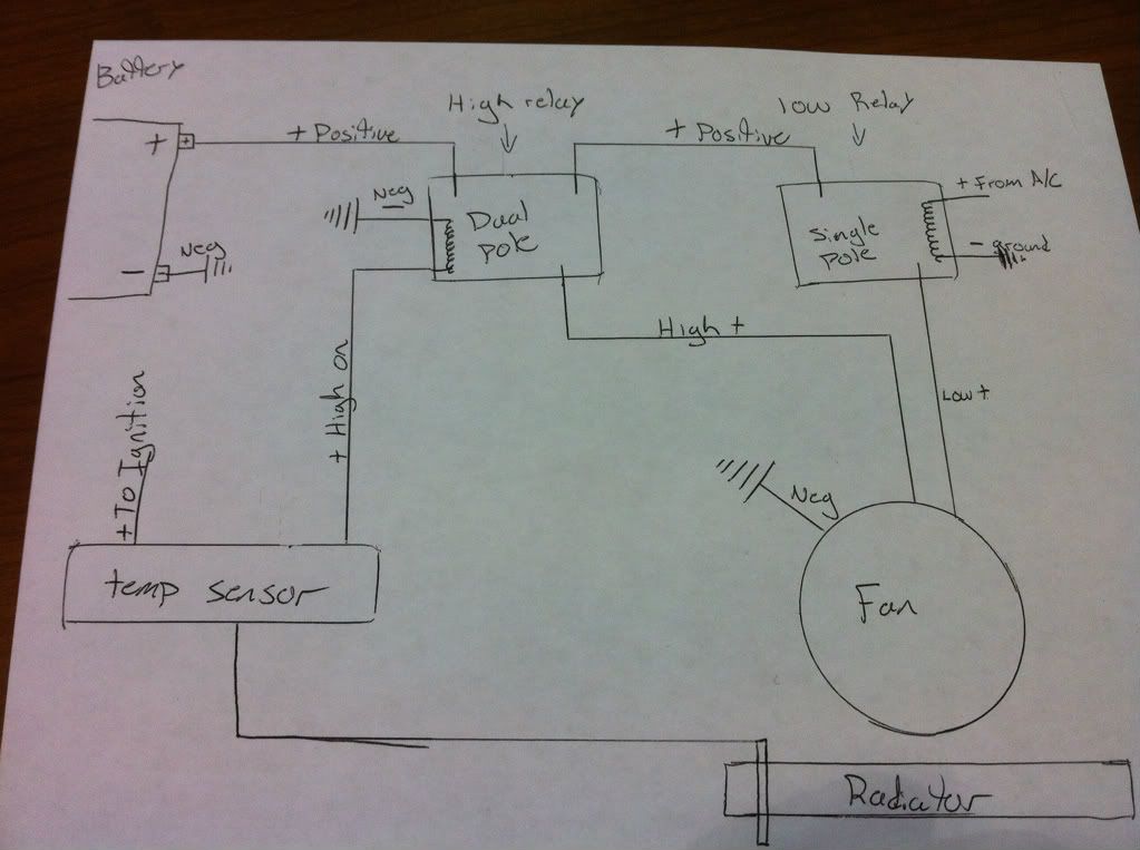

i run a 93 topaz fan. works great, cools my 4.0
all you need is 2 waterproof 30/40 amp relays, and an adjustable temp sensor. and i sure hope your good with soldiering, as butt connectors and electrical tape will cause this mod to leave you stranded with a overheated engine.
my wiring schematic:
