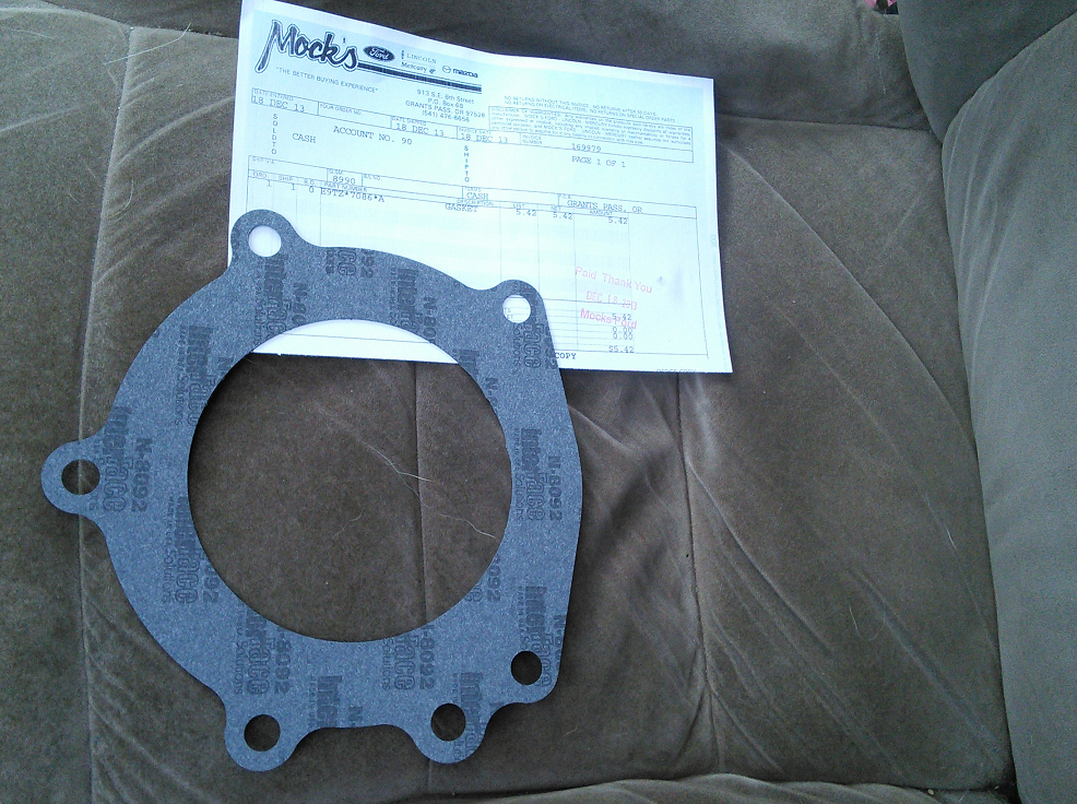

Just a data point for those that search; I needed a gasket for my manual transmission (parts guy said automatics took a different number) to transfer case and went to the Ford dealer in Grants Pass Oregon, USA Dec 2013.
Part Number E9TZ 7086 A $5.42

I generally just use silicone. Sometimes I don't even bother with it. As long as none of your seals are leaking the gasket isn't really needed.
pretty sure mine has a drain channel in the bottom anyways, the gasket doesnt do anything.
