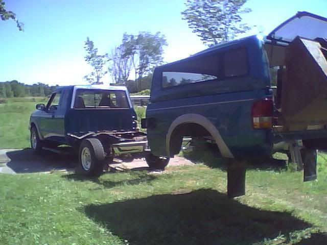

i used a tractor with forklift forks on the bucketof a front loader of a small farm tractor, i had cut 2 2x4's to fit under the bedrails, took the tailgate off, and lifted the whole bed & cap off as a assembly. i realize not everyone has access to a tractor with a loader, but if you do, it sure makes it alot easier!

I'll be starting this project today or tomorrow. Anyone know how heavy the box is? Do you think it's something 3 guys could handle lifting? Thanks
i could lift one whole side easily off the frame, i would think that 2 guys could lift the box, with 3 im not sure where youd put the 3rd guy, perhaps behind the wheel one the bed is lifted to drive the chassis out from under the bed.
I was thinking if you had a 3rd guy, 1 on each side but a little more toward the front & then the 3rd guy would grab the back end.
