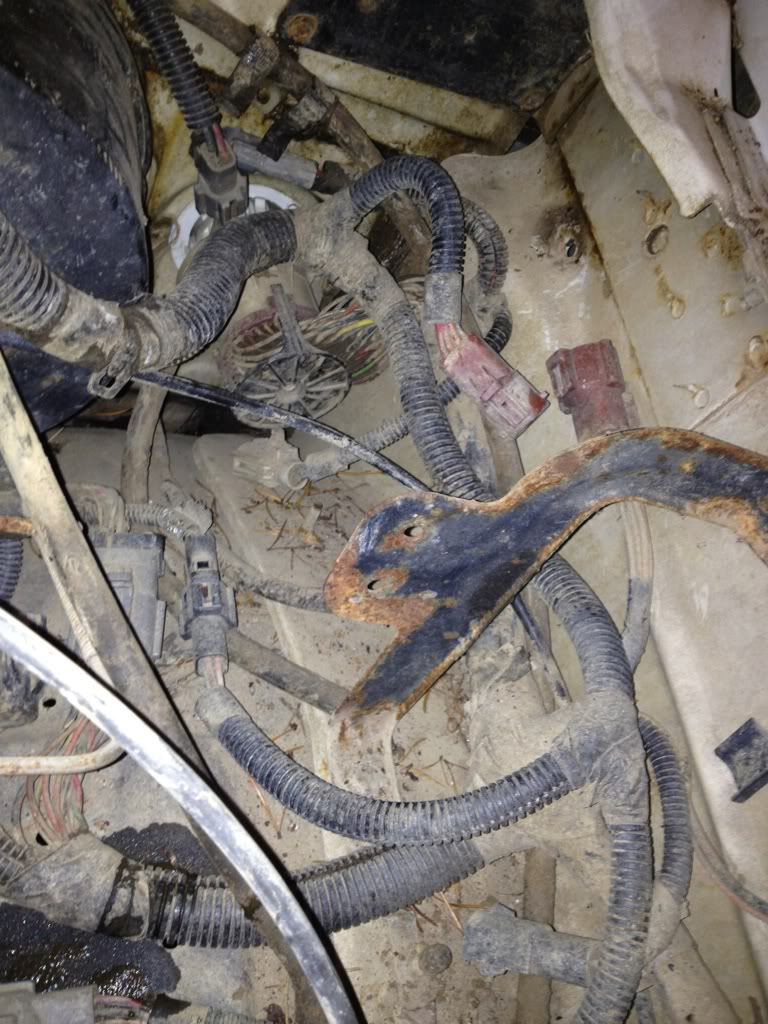

Heres my 4.0 from the 91 explorer 4x4 auto trans
seeking 2.9l to 4.0 4x4 manual swap help and electrical guidance
the explorer had a custom built snorkel running into the cab the body was very rough but the engine ran great :)

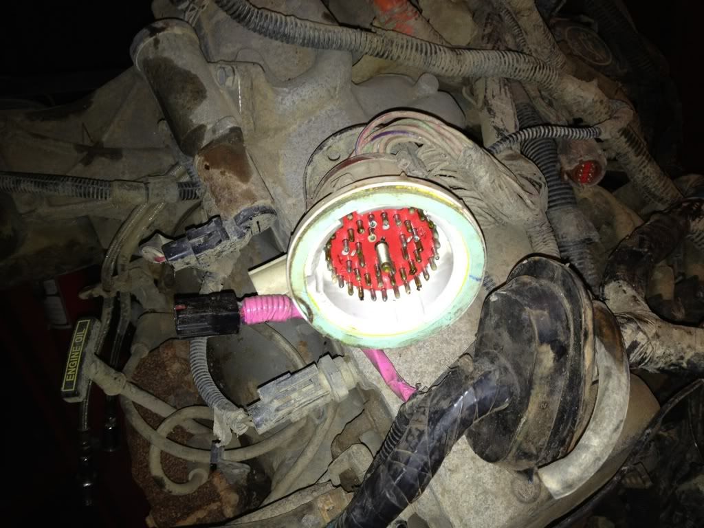

so im hopeing i can plug this big white plug on the drivers side cowl from the 4.0 harness right into my 89 b2 MAn trans 4x4 harness (im guessing im going to have to keep the existing man trans sensor wireing part of my harness and incorperate that into the 4.0 harness to make it work

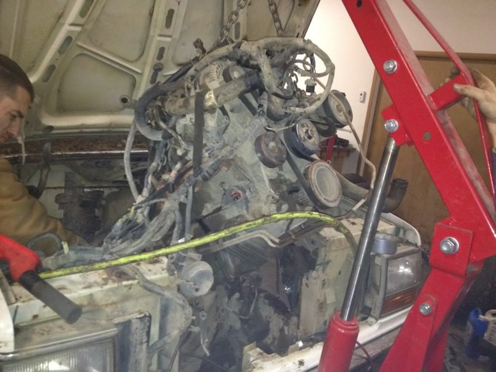

Heres the 4.0 leaving its old home !!!! we cut the core support so we could slide the engine trans and tranfercase all out as one unit the explorer is headend to scrap after the owner gets the D35 off the front for his 4.0 ranger

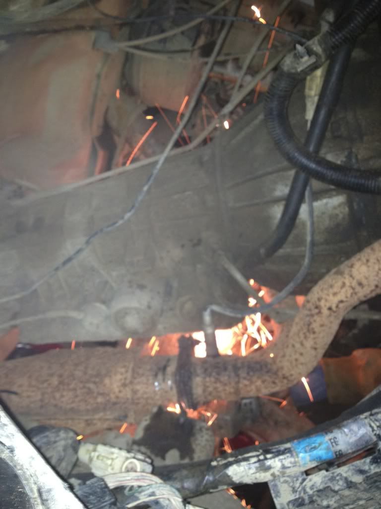

Here were cutting the cat of at the Y Pipe flange so we can get the tcase through the trans tunnel it was a lil tight with a couple cats along side it

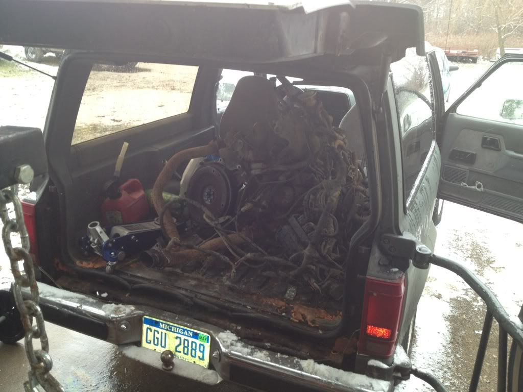

THERE IT IS LOADED IN THE BACK OF THE B2 AND HEADED HOME!!!!!!

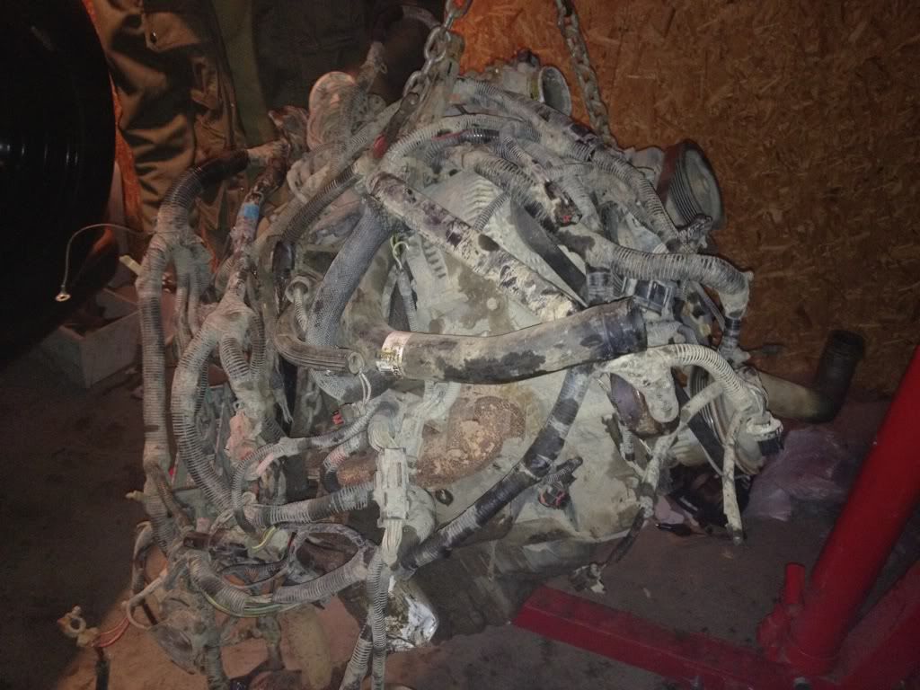

Here it is back on the picker in the garage LOOK AT THAT MESS OF HARNESS O.o I cant wait to dig in

OKay Here my First Question On Wireing now that i know a lot more of what im getting into
IF i plug this plug into the female end on my 89 4x4 man trans 2.9l harness will any wires not be on the
right pin or will i have to cut wires at that plug??
