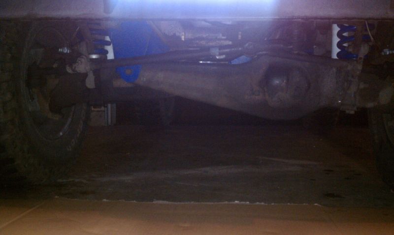

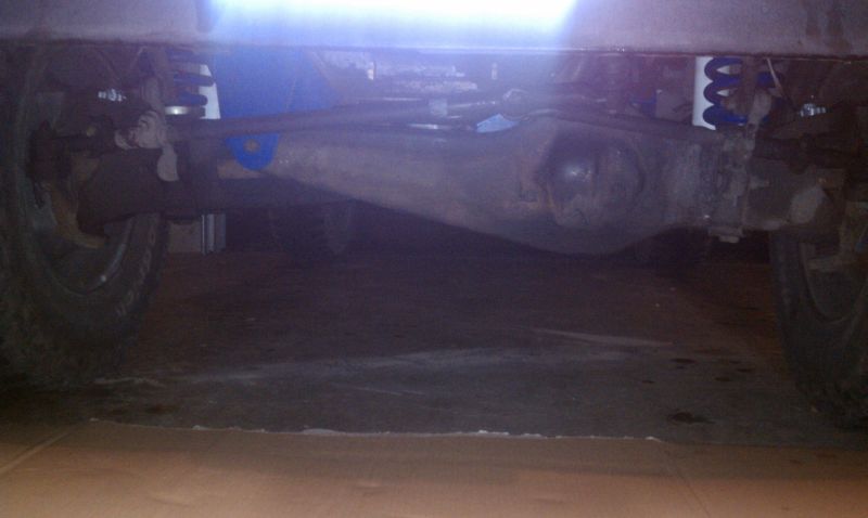

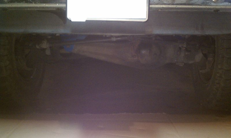

Also, a picture of the the tierods straight on is worth a thousand words.
running the stock, kit didn't come with one. did some research in the forums and library and saw that it might be the fix i need. i just don't want to spend $500 on the superrunner kit, if all i need is the $130 skyjacker one. i'll post a pic as soon as the camera charges a bit.
i hope the pictures loaded. might be a little dark.

A regular drop arm will put you very close to where it needs to be and clear up most of your bumpsteer issues.
I'd only go the SuperRunner route if you plan to run a total of 4-5" of lift in the near future. Sometimes one can find one used for much cheaper....
I'd save the $500 and just go with the Skyjacker, not that much of a lift and you "should" be able to get by with the FA400. I believe that a drop pitman arm for a 4" lift is only a 2" drop actually ie: Rough Country, Tuff Country
Yeah you need to do something with that steering for sure.
A drop arm (Skyjacker FA400, etc.) should help out a lot, however the Superlift Superrunner steering kit would be even better still (especially if you drop the centerlink on it down another inch so it matches up with your lift exactly). I wouldn't say it's completely necessary on a 3" lift though.
