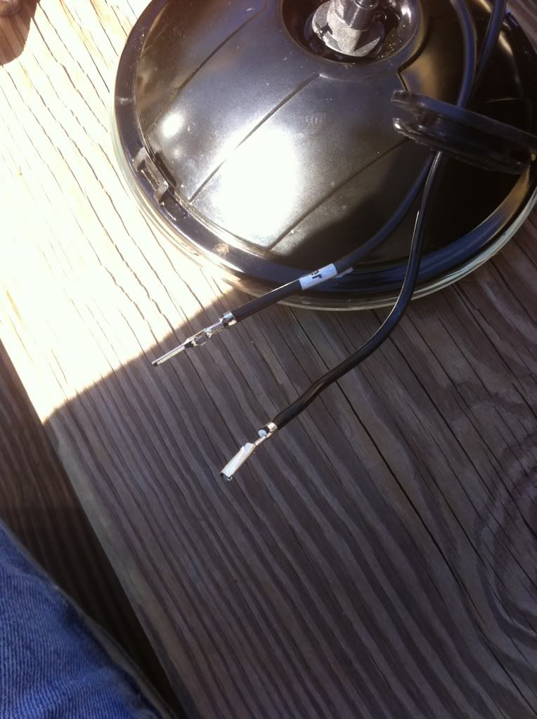

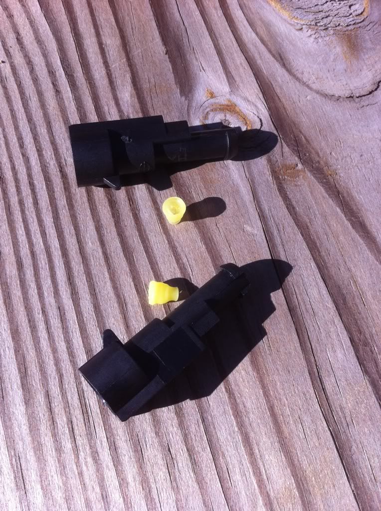

take the ends off the HID bulb wiring, so they can be pushed thru the Hella gourmet and thru the factory hole in the Hella, no drilling in the housings involved, super clean look
My Hella HID Conversion
the ends do take a little pulling to get off since they have those "watertight" rubbers in there.

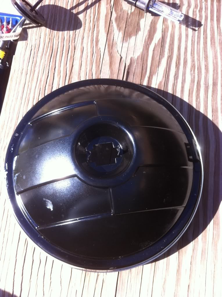

this is where it gets interesting, and i stopped b/c I am hungry and b/c I don't have a heat gun. The plan is to "bubble" out the back of the housing in the center just enough to make the HID bulb (has a bigger back and the wires) fit in the housing w/ no drilling. I'm going to get a heat gun after I eat.. mine decided it was finished working, its being retired to the trash can.

here's the completed housing
side view--notice the little bump. that's all it needs.

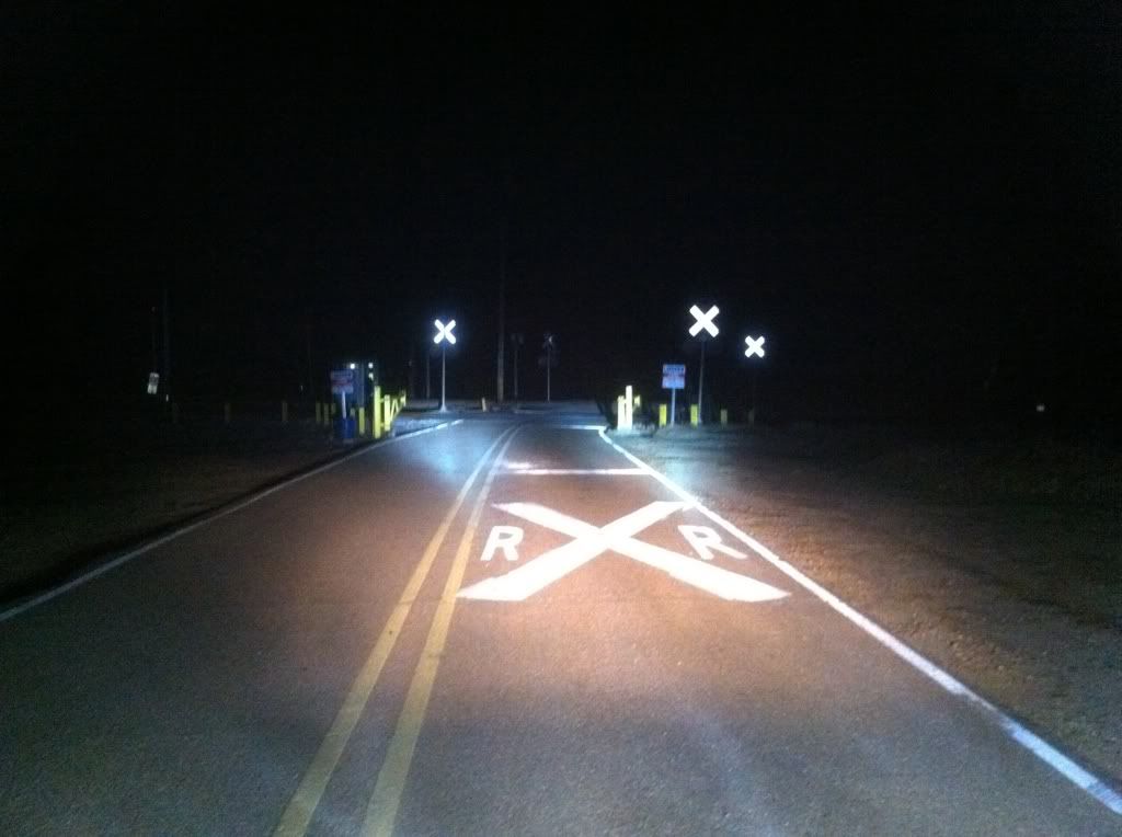

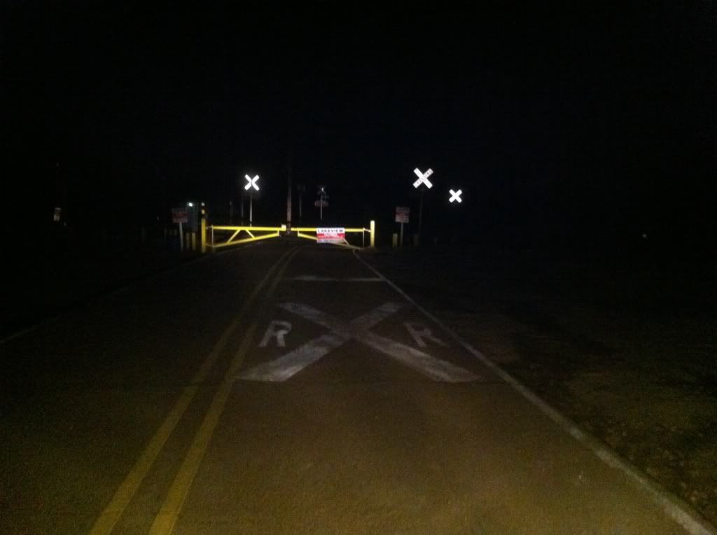

Hella's and High Beams Before
Hella's w/ HID and High Beams

one thing about these Hella's w/ HID is the "clamshell" effect that the light pattern gives in the hotspot.. doesn't bother me.. but it might some people.
the hotspot is not as bad as it looks in the pic, and the rest of the light is brighter than shown.. pics suck for lights.
