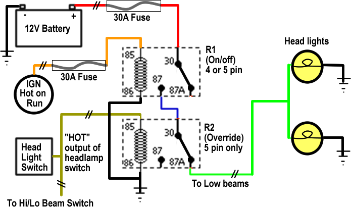

Here is the wiring diagram to make it all work.
This is a single setup of just DRL or Auto Headlights, if you need both, then you need to do this twice.
DIY DRL's
Here is how this mod works..
When your ignition and headlight switch are off, you have no lights, like normal.
When you turn your ignition on, it activated relay 1 ( Normally open ) sending 12V to relay 2 ( normally closed ) turning on your lights.
When you turn on your headlights you activate relay 2 breaking the circuit, how ever you lights will still be on due to the headlight switch being active.
total cost of this mod is around 15 bux with all parts.
Enjoy.

Parts List vs Diagram
Sorry, I know this is an old thread, I just got my 2001 Ranger and am looking to add DRL and I don't wanna spend $70-75 online for the module. I'm a little confused, in the parts list you have (2) 15A fuses, but in the diagram you show (2) 30A fuses. Which did you use?

The fuse in the red line supplies power to the headlights, so should be 15 amp. The fuse in the yellow line only supplies the relay coil, so any small size fuse will do. In that circuit I would use anything I had between 1 and 10 amp.
Paul
