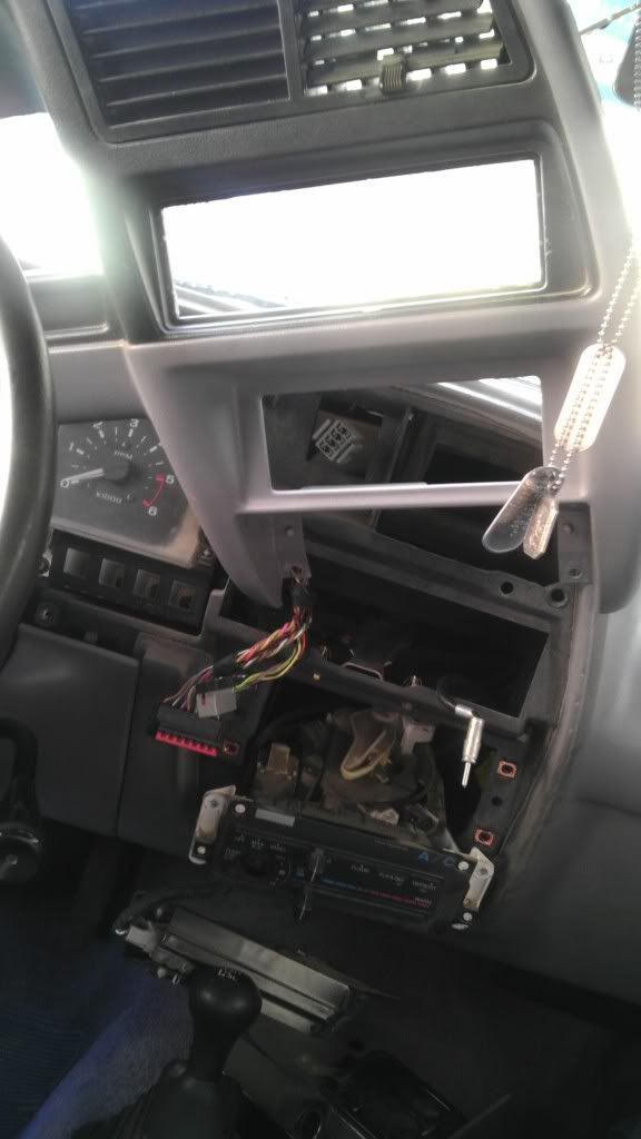

Changed out my little AC/Heat control thing knobs were broke on the old one!

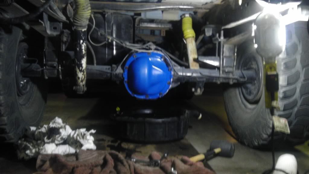

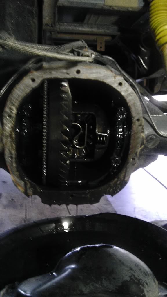

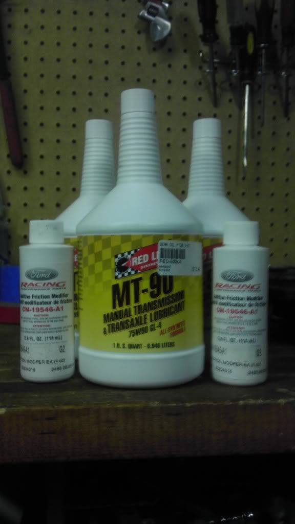

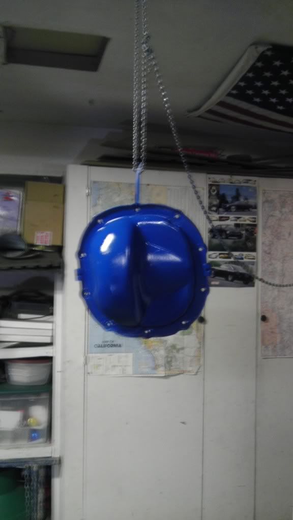

Serviced the Rear Dif
(Ignore the blocks and my 2 leafs, getting Chevy springs next couple weeks)

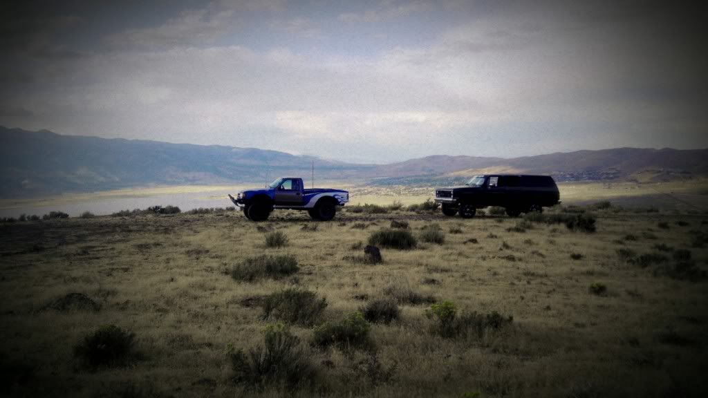

Wheelin

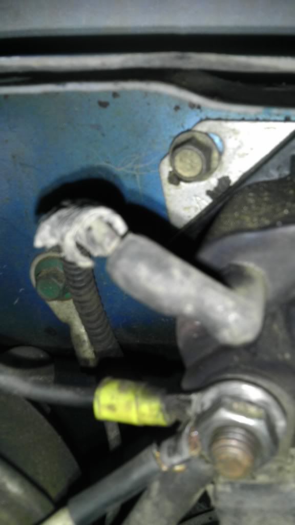

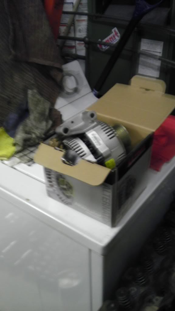

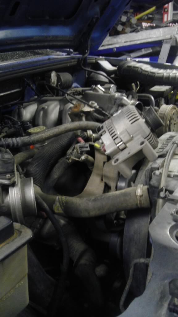

My battery started dying and wouldent recharge so I got a new Alternator, That wasnt the problem... a ground had melted off or somthing... so fixed that and wallah!

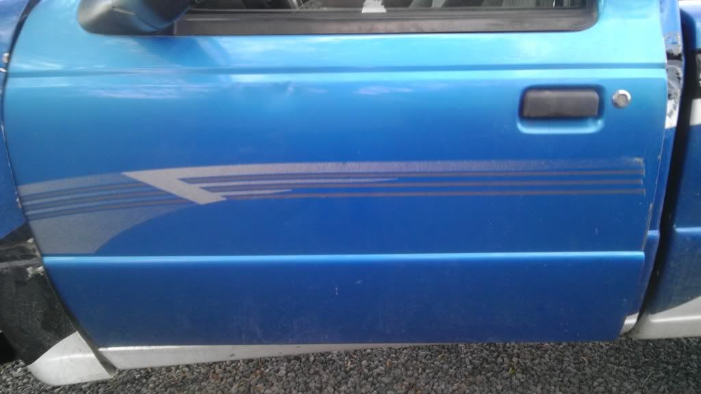

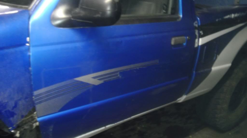

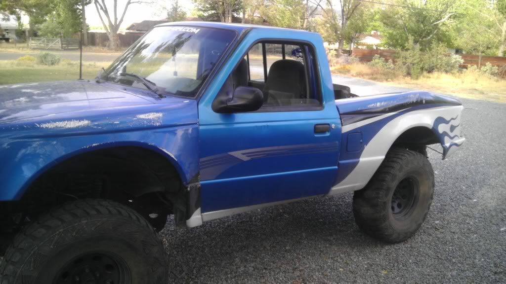

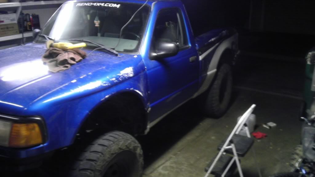

Found a Closer matching door! It will be easier to paint! My body work should be starting when my letter of Intent gets approved. (Those who are in the tailgate pry know what Im talking about) It has/had the decal on it, I got a decal remover wheel and went to town!

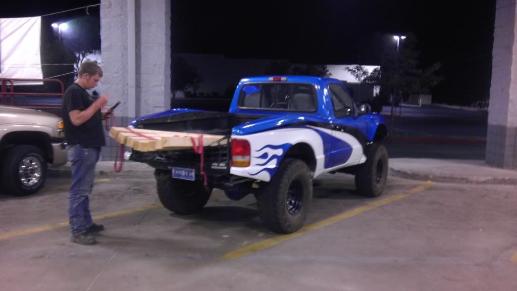

Hauled some lumber!

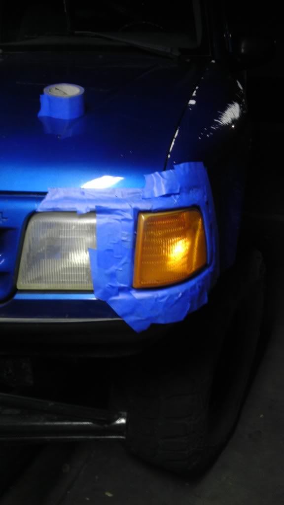

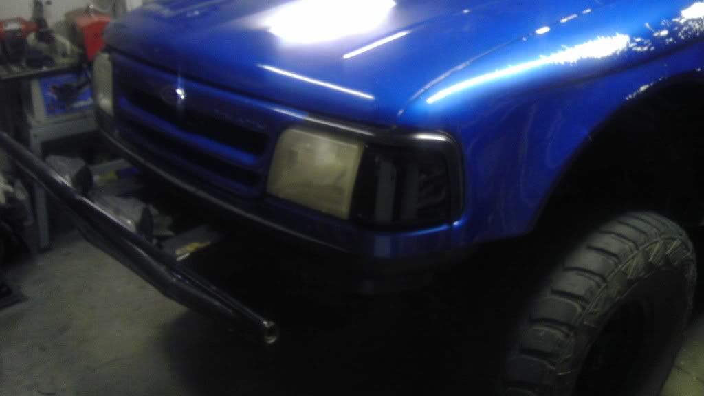

Blacked out my reflector things. I didnt take a picture of the other side because my brother is horrible with a spray can and it ran... so yeah

the U.S. flag looks godd.......errr...goooooood on the ceiling.......
blue looks good on the diff. cover....

I wouldn't use that Redline in the rear diff. It's only GL-4 rated, which is fine for manual transmissions but not for diffs. You need a GL-5 rated lube which has the extreme pressure additives in it for a rear diff.
