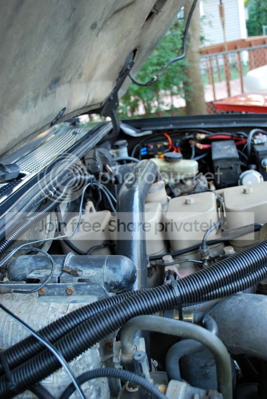

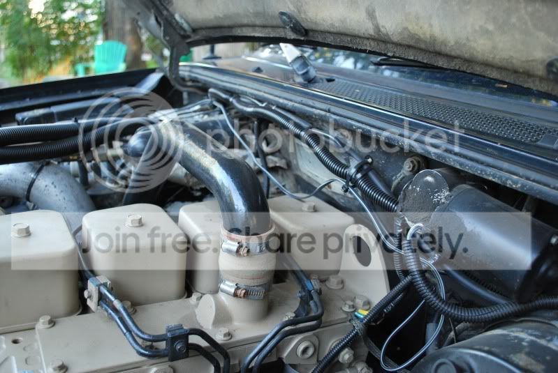

some of you have been asking about my truck so here are some pics and info:
little heavy (thats the other diesel i picked up at a swap meet)
as for some details: M5R2 f150 trans, 4" rough country lift with 2" body.
not done yet:
expo 8.8 will replace the stock 7.5
divorced np 205 tcase out of a late 70's F250
D44 of out an EB, converting to discs.
intercooler
hy35w turbo
fuel pin and upgraded injectors
questions? other than cost of the project, :icon_surprised: bc i have no idea i lost track a while ago and it was NOT cheap lol thats easier
doors and fenders and tail lights shaved, tailgate is next
bumpers are 11 gauge steel. front is one solid long piece bent around a template
rear was pieced together from the left over sheet from the front
lights on bumpers are 3/4" dual purpose outers are running/turn
what else??
grille i didnt really have many options that werent over priced so i just picked that one up for cheap
