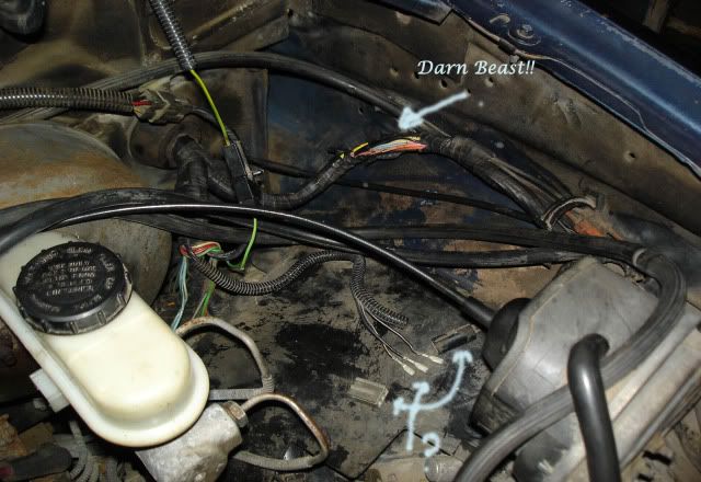

Hello to all.
I have a 1986 Ford Bronco II. Woohoo!
Unfortunately it caught on fire due to some leaves in the heater core. Waaa!
Insurance Co. totaled it and I bought it back. That was 6 years ago and it has been sitting ever since. I did start it a few times and it ran fine other than having a huge hole in that plastic covering. Bought another used vehicle to drive. Being very depressed about sinking a bunch of money into it then it catching on fire, I gave up trying to replace that plastic compartment...all kinds of AC stuff in the way.

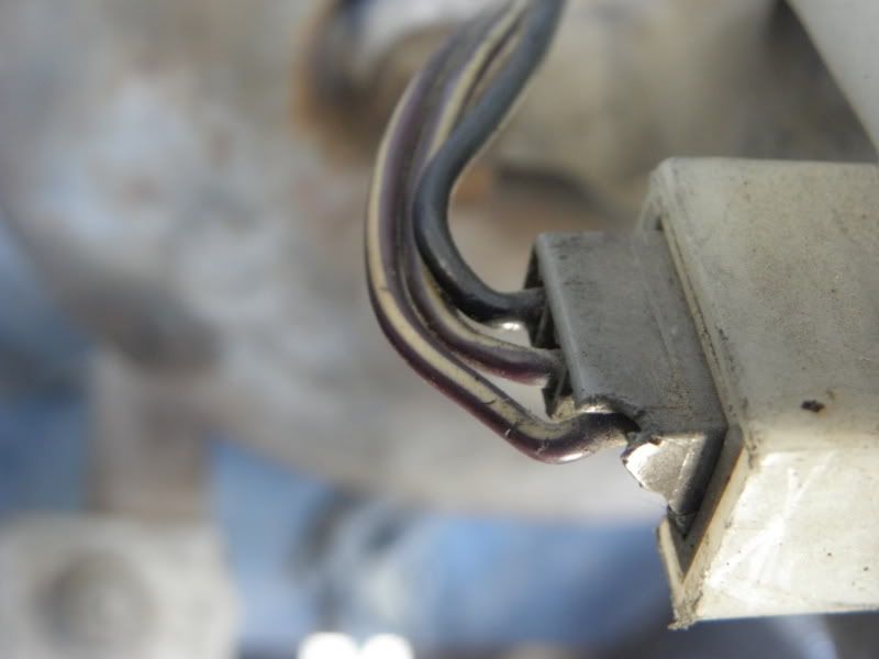

So...it sat and now I want to try to get it going again. Alas...some darn beast ate some wiring, messed with a connector even with moth balls and "snake away" in there.

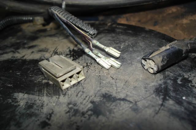

I think I can fix the wires though there is one apparatus they played with and I have no idea where it goes or which of the three wires go where when I find a new plastic connector.
Also removing spark plugs to put Mystery Oil in the holes but one plug seems to be stripped where the socket fits over it. Any way to get it out, short of hauling it to some one and paying to get it out?
Haynes manual does not tell me much in their pictures. Looking for a place I can get a map of all of the sensors/connectors. Is there such a thing?

Go to www.autozone.com. Become a member. Go to repair info, Find wiring diagrams on left side of page. Should get some wiring diagrams. Of course you have to fill in the my vehicles section first. Not great but free. If you need a picture of something show me what area you want one of and I will send you a picture of my 86 for you to compare.
Hello again FlatToy. :icon_thumby:
Thanks for sharing and the offer. It is on the driver side of vehicle for now. Over the tire well is where I found the items shown in the pics. A darn beast had chewed one end of that connector and the wires were pulled out. No idea what the heck the round one is to.

The flat plug goes to the brake resovoir. The wires should not pull out once they are pushed onto the sensor. I would force RTV into the plug where the wire comes out. That way next time the plug comes off the wires will stay in plug.
FlatToy...you are the best. :-)
Thank you ever so much. Time, pics and sharing. I was looking everywhere in tire well area. Will do as you suggested and keep looking to see where the round connector goes.
Looked on the LMX site and no connectors. Salvage yard here sells the entire wiring in engine compartment for $150. May have to consider that one day.
Thanks again. :-)

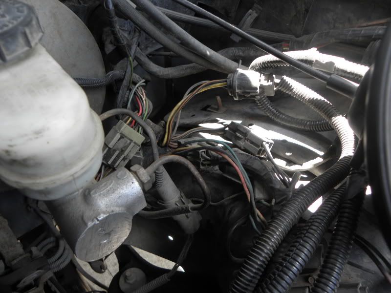

Give us a close up of that section of wire that has been damaged. from the view we have it does not look too bad. Let us see it up close. If I remember right that harness is door locks and elect windows. Might be one wire to battery.

FlatToy..I don't have power windows, locks..you may be onto something with the round connector. Jhammel or you have power locks/windows? I don't think the chewed wires are that bad as there are only 3 with missing wire and 2 with breaks in them. There is room thankfully.

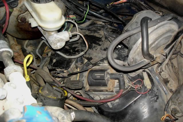

chrwilkens...I am going to post pics of the coil. Thanks.

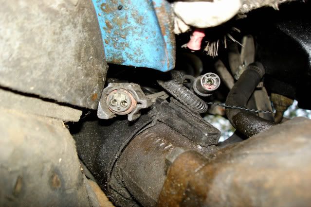

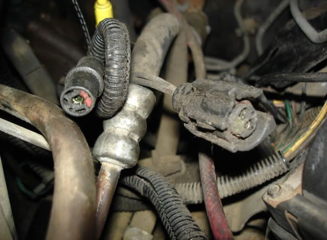

OOPS! Another wayward connector hanging loose under block? behind pulleys..
Brother had me turn bottom pulley to make sure engine was not froze up. Yippee!! Pulley moved without too much leverage. While under there I looked around and saw the connectors. Will fix wires and find out where that connector goes this weekend.
First two pics were taken from me on ground looking up toward hood.
Third pic was me putting wire at top to get a better shot of them.
Fourth show coil/etc.
