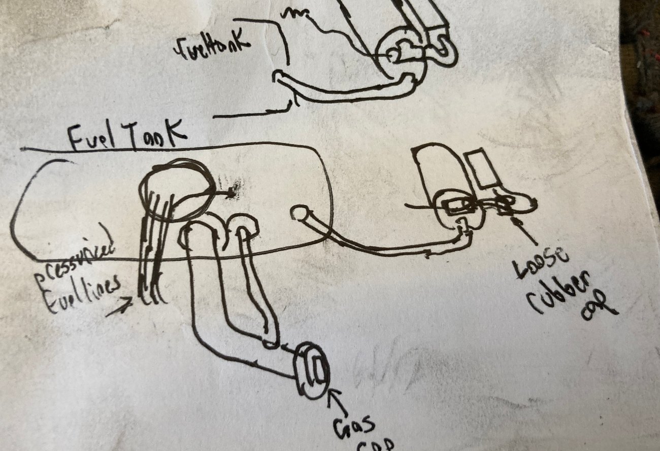

are these the only lines and items (attached drawing) related to p0442 gascap - evaporate leak code?

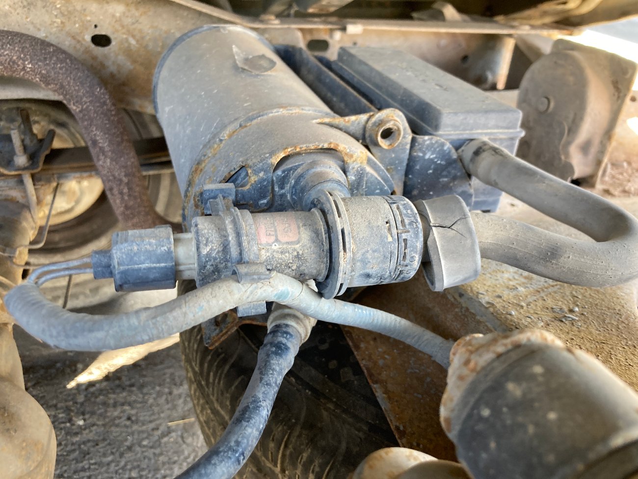

gascap, fuel filler lines look fine., the line from fueltank to evap canister looks fine. i believe there is a checkvalve somewhere in there that must be inspected for failure?

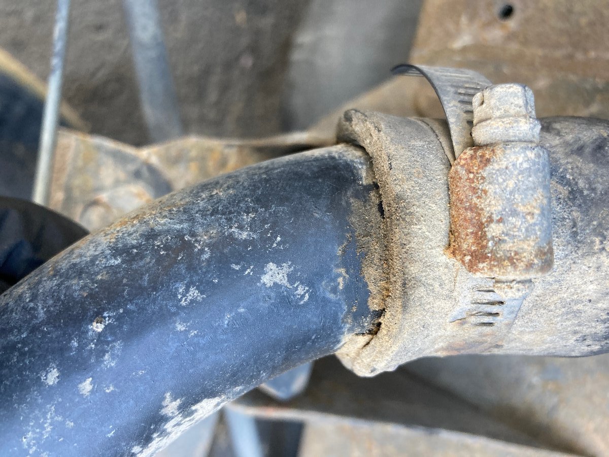

-i had a rubber boot fail near evaporative canister, could that cause issues?
-there seems to be wet/moist dirt/crud around the hose connected to fuel filler neck. is that a sign of a leak?
-my lines are covered in years of alkali dust from burningman dry lake bed.
are there any other lines elsewhere in the truck that need to be inspected?
can i disregard the high pressure fuel lines drawn on the left of the drawing?
