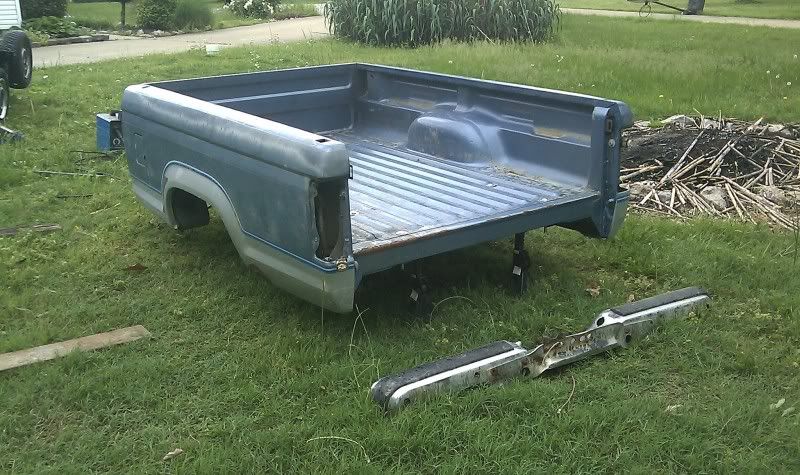

Well I borrowed my mom's trailer to move a few months ago and ever since then it has been at my house and I keep finding uses for it. I also was in the market for a 2wd Ranger for a project and also so I could haul stuff. Well I have decided to wait a while on the Ranger since work has slowed down and I shouldn't spend the money on it. So I came across a Ranger bed on CL for $100 and decided to go for it. And after some constructive criticism from some of you guys on here, I decided to go with 2" square tube for the main frame, and use some left over HREW tube for the braces.

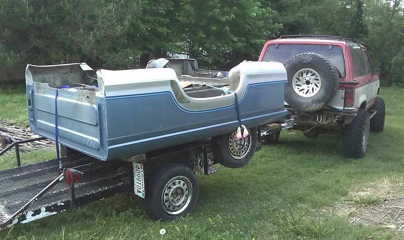

Here it is on my mom's trailer

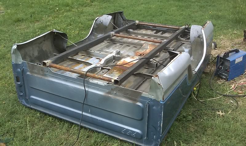

And some work on the frame
And here it is sitting on it with bolts loosely attached to keep it in line

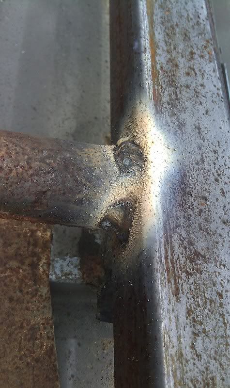

I must say my welds are getting much better

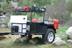

And here is an idea of what I am trying to accomplish
Thats a good start on your trailer. I toyed with the idea of using a Ranger bod for my trailer too. But they are hard to find around here. Instead, I am building one like this...

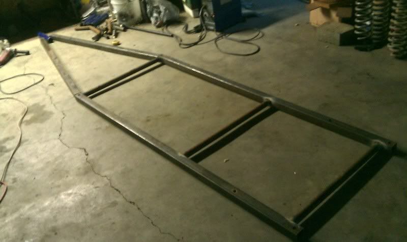

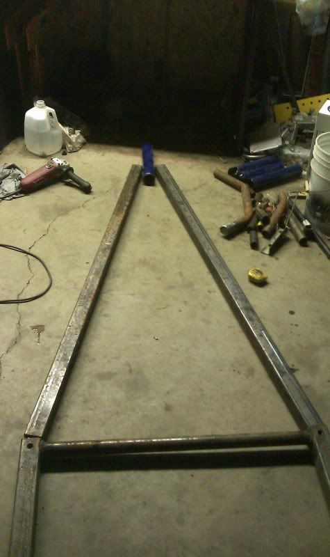

Mock up of the A frame. It is going to be about a foot shorter for a total length of 4'. The blue thing is going to be a short piece of square tube for the receiver to mount to.
Gonna use a ball, pintle or max coupler hitch?
Planned on just a ball for now.
I planned on using the max coupler since mine will be used primarily offroad.
I'm not really sure the differences, but I do like slo-vo's swivel he has on his. I just don't think I will need it.
max coupler is great if you can afford it, and plan on using it for some good offroad stuff.
