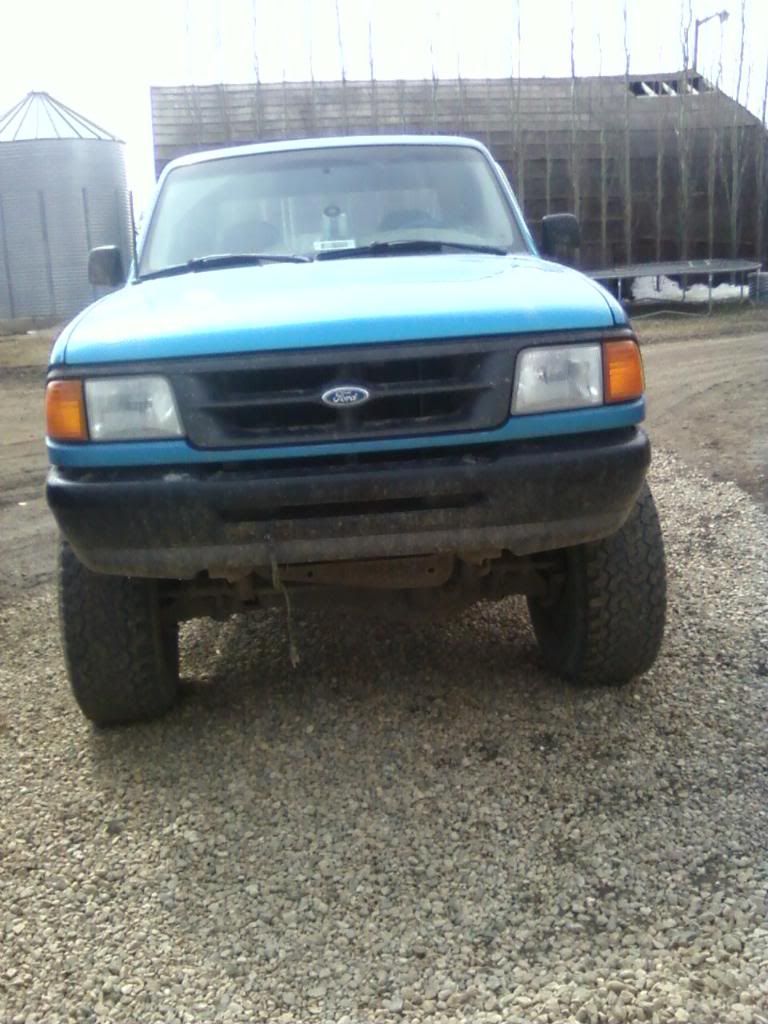

Front side of 1996:
Dweano's 1996 AND 2001 Front End Swaps
Front of 1996:

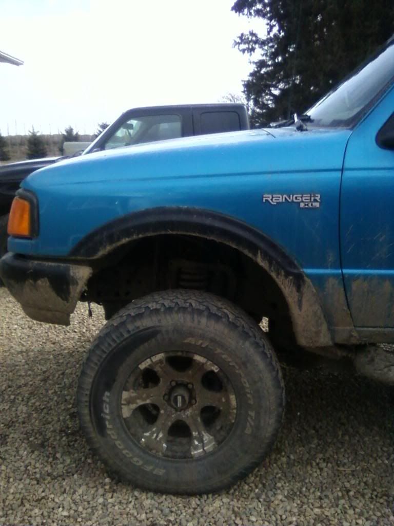

Angled other side of 1996:

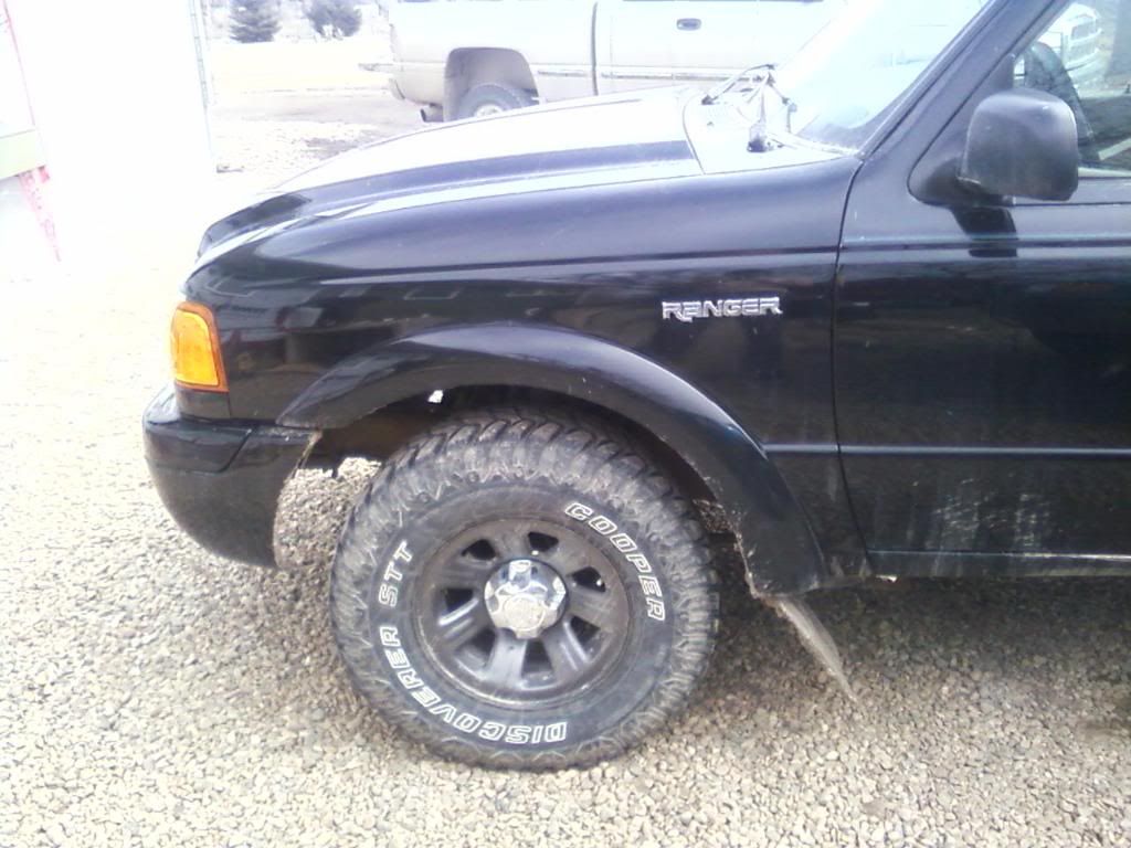

Side of 2001:
Front of 2001:
Again:
Other side of 2001:

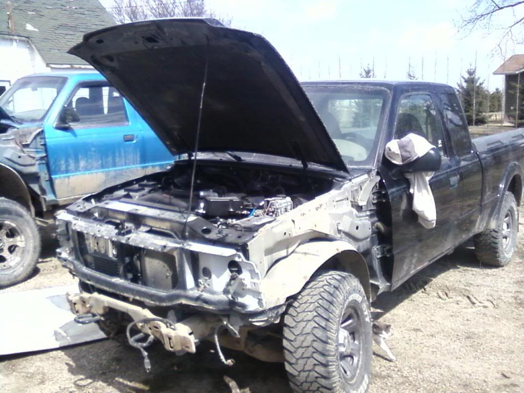

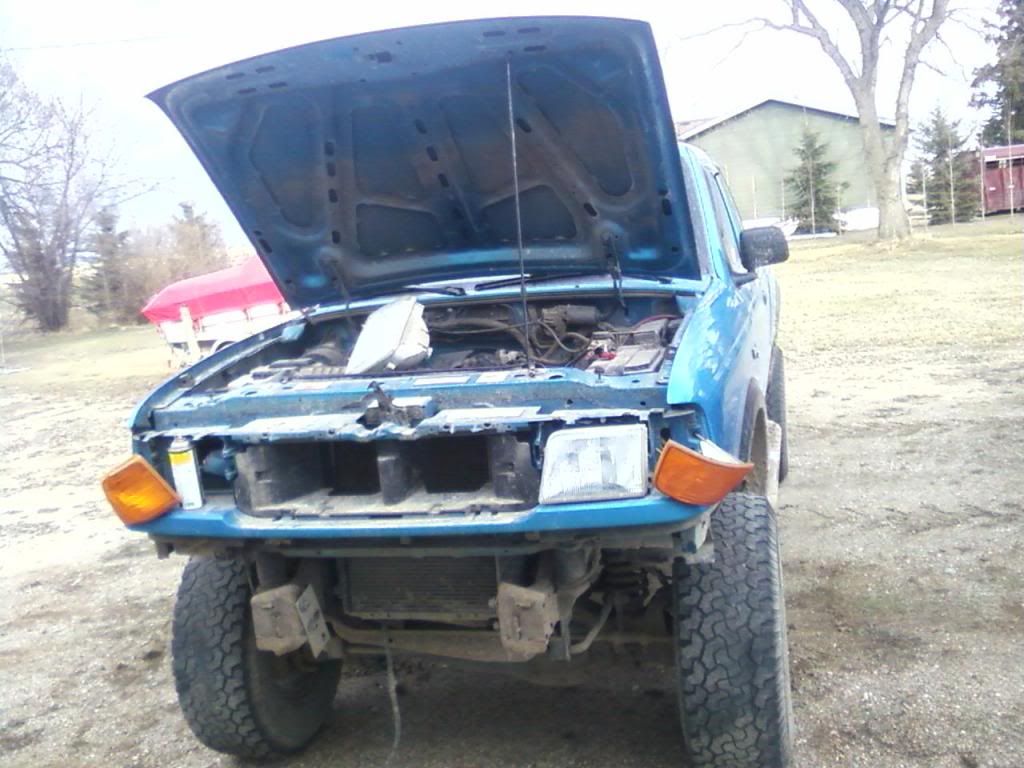

Whoop Whoop! Finally got started on this today. Way too long after I said I would. I also picked up some spot weld cutters recently so that should help me out. Heres how far I got:
I am pretty much just taking things off willy nilly...is there an order I should be following? Then reverse it for reassembly? Any input would be much appreciated as I am feeling quite over my head.

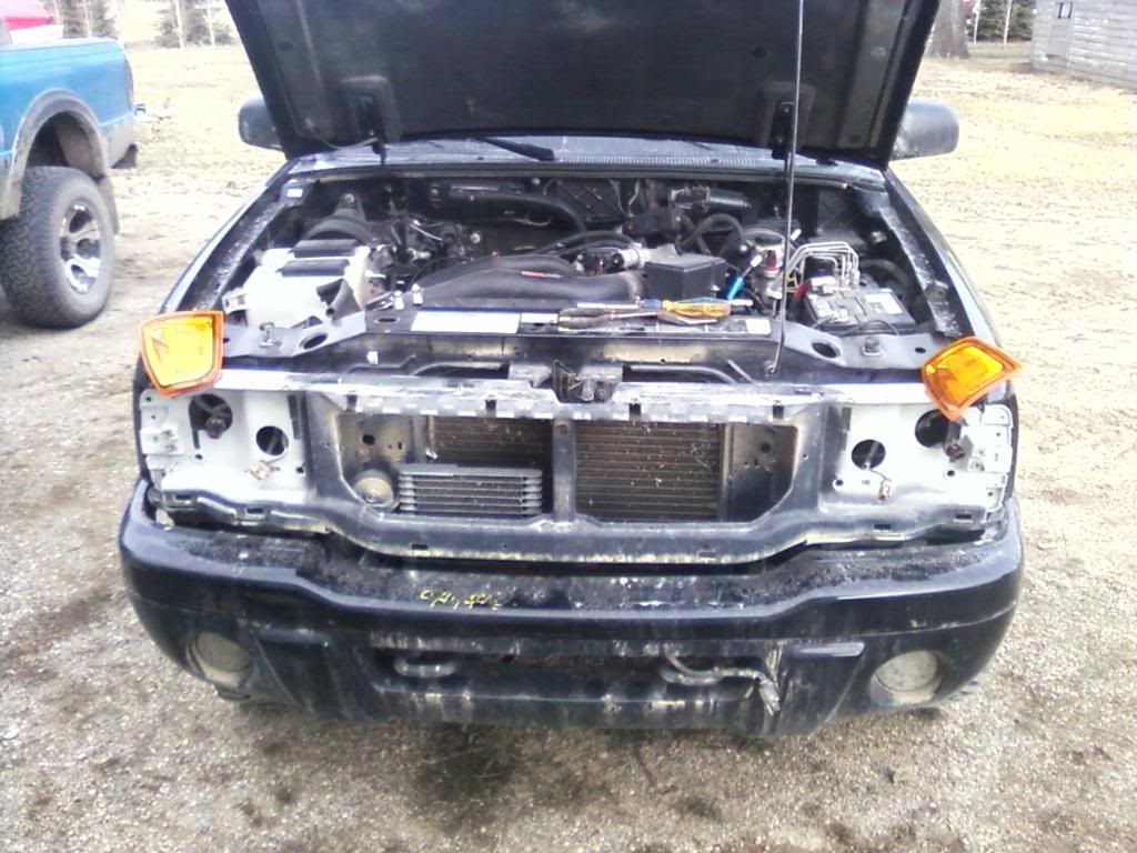

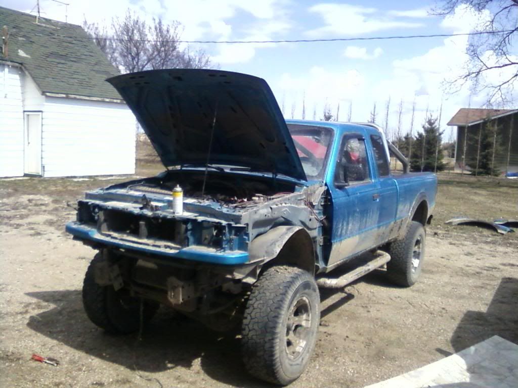

Due to work and no shop and crappy weather and my procrastination skills..this is the slowest progressing project in the world. I did manage to get the fenders off tho, and the header panel and lights are off, all I have left to do is swap the core supports and start putting things back on. How do I swap the core supports tho? There seems to be millions of spot welds everywhere...should I just drill them out and use bolts? Of use my spot weld cutter and just cut the one layer and leave the other stuff intact? Also..the bottom of my 96 core support is rusted to crap. I guess I will just have to make due with whats left. Heres some pics with the header panel still on:
you need to take the header panels off. They are still on there. Its the black and white thing on the front of the core support for the 01, and the blue thing that is bolted on the core support of the 96.
If it is rusted, you are going to have a hell of a time getting it back on the 01.
I have a buddy on another forum that did the swap. I am trying to find his thread, I will get all the info you need, and get back to you
Yeah I did take the header panels off...just after I took the picture, I am learning what all this stuff is now that I am diving into it. Slowest progress ever but its coming slowly. Its rusted at the bottom...I can snap some pics sometime...I think if it comes off good getting it back on shouldn't be too bad. The core support just looks like a biotch to get off...randomly spot welded and what looks like patch welded onto the inner fenders. That Josh! That would be helpful, thanks for your help already
