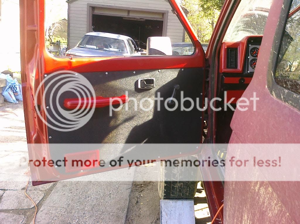

i did mine is abs plastic too about a year ago. not only do i agree with everyone else about rounding the corners......i suggest pan-head screws too
this pic is from so long ago my truck is still red in the photo
my truck is an 89 and cammeddrz i got the abs plastic idea off ur picture i just decided to go a different route with the arm rests
