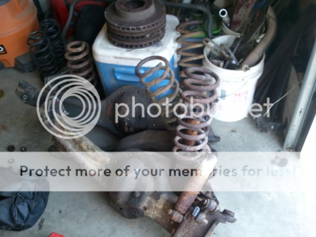

Couldn't find any 44 TTB's in the junk yards so I put a ad on Craigslist . This guy call and said he had a 80 F150 and a 83 Bronco . $75 a piece without the 3rd's but that's all I could find and he was willing to cut them out with a torch .
I know this doesn't look safe but we got both of them out and loaded in an hour .

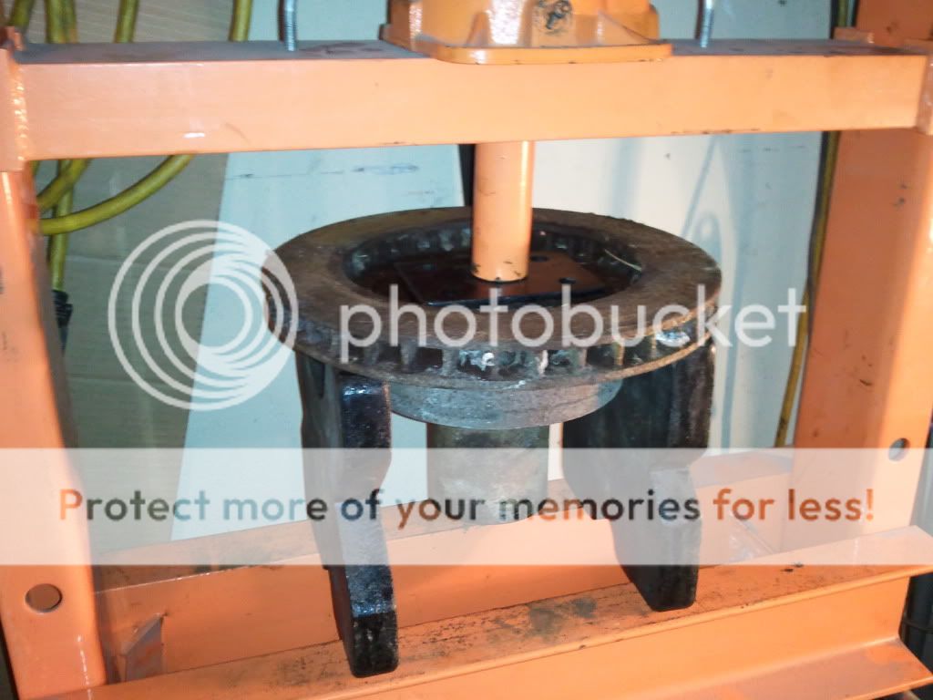

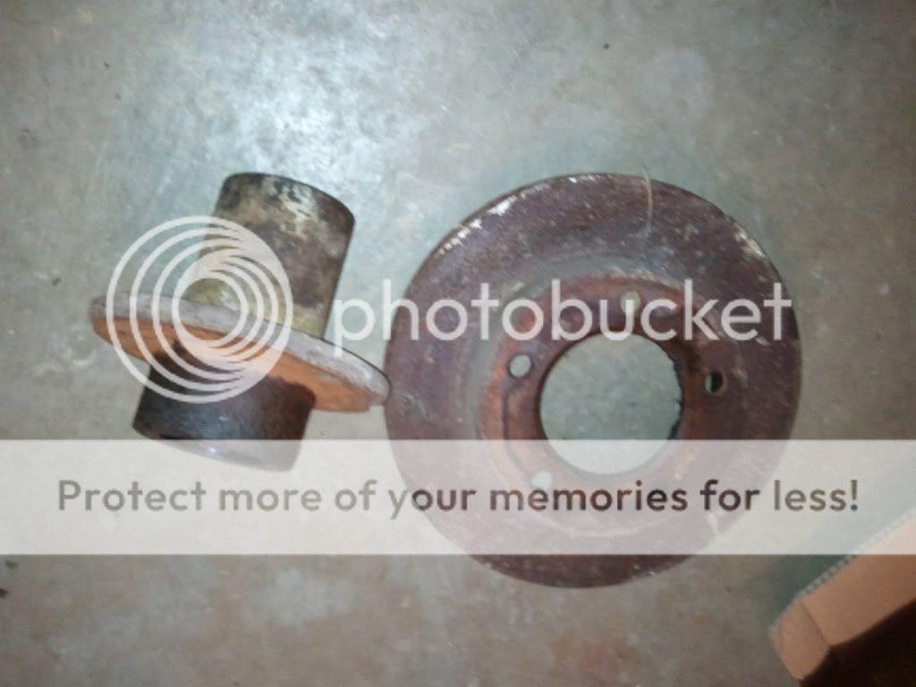

Pressed all 20 of the wheel studs out .

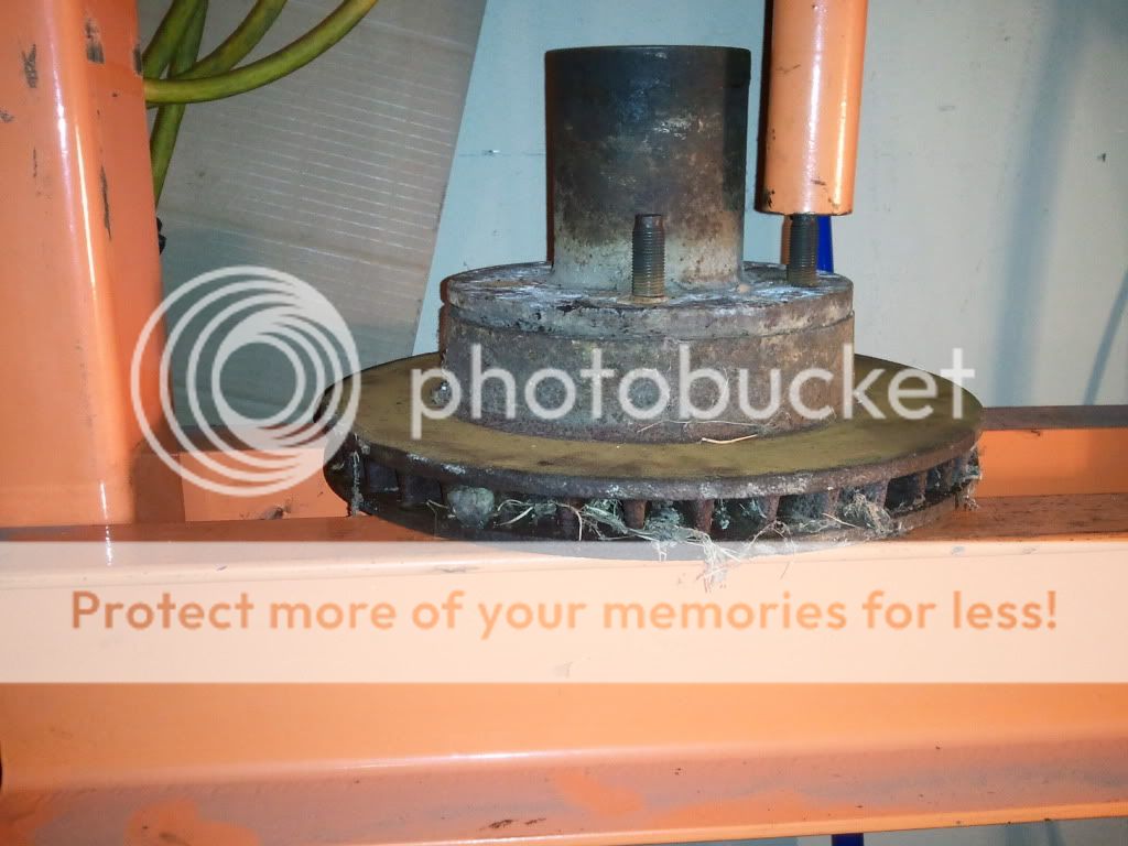

Pressed the hubs out of the rotors .

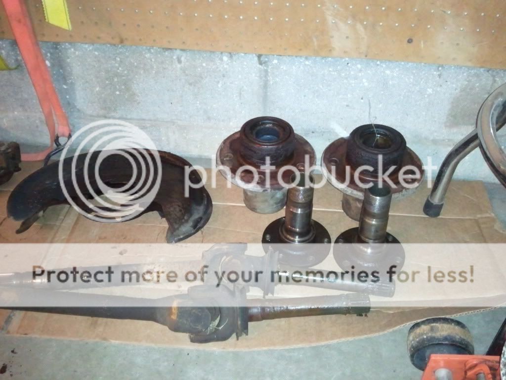

Took the spindles off and pulled the shafts .

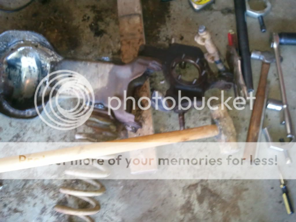

Tomorrow I'll try to get the knuckles off the beams . That should be fun .

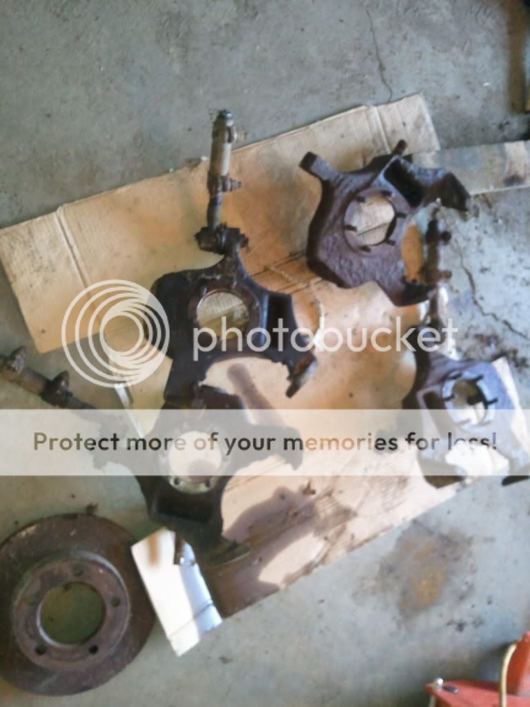

Got the knuckles off the arms . Wasn't going very good so I ask slo-vo for some tips . He told me to put the arm on a block heat the bushing and get the biggest hammer I had and go to town . Well I don't have a torch but I had what you could call a big hammer . Took about 3 hits each on the upper ball joint .
