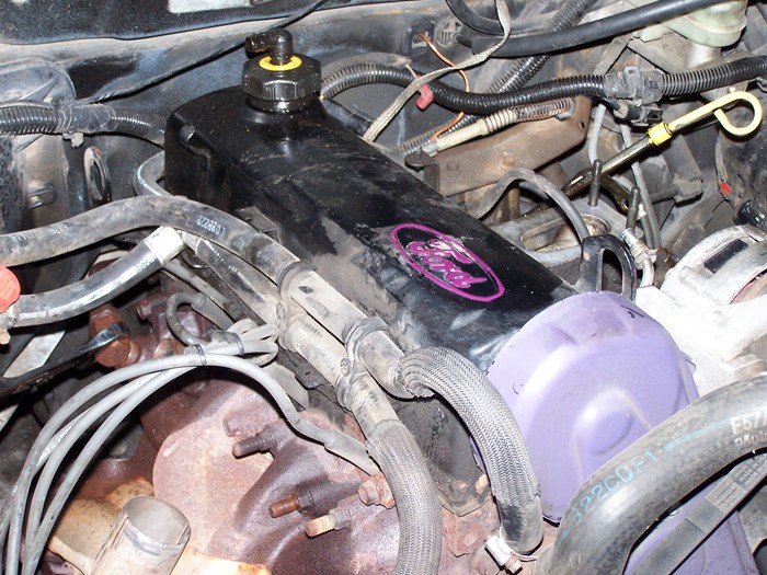

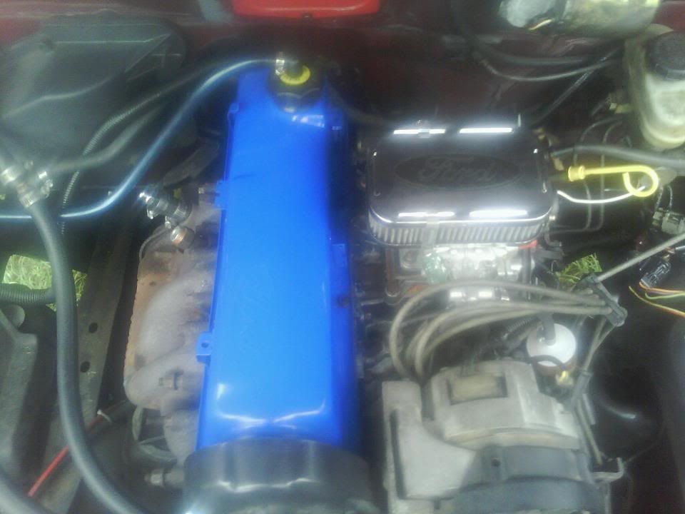

Ok I have posted before that I would post up some pics and details on how I installed my weber 32/36dgav on my truck so here goes:
first I started removing all the smog crap on the truck cause most of it was junk this is what it looked like at first.(FIRST PIC)

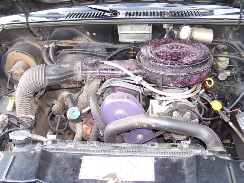

secondly I removed the carb then the carb spacer and egr.(SECOND PIC)

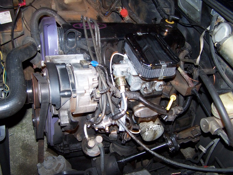

I then took the egr gasket off carefully and trace it onto a piece of aluminum I got from a friend and cut and shaped the piece to match the gasket and drilled the mounting holes to make a block off plate(this step is not necessary but I removed the egr cause the pipes going to it were damaged).(PIC THREE)

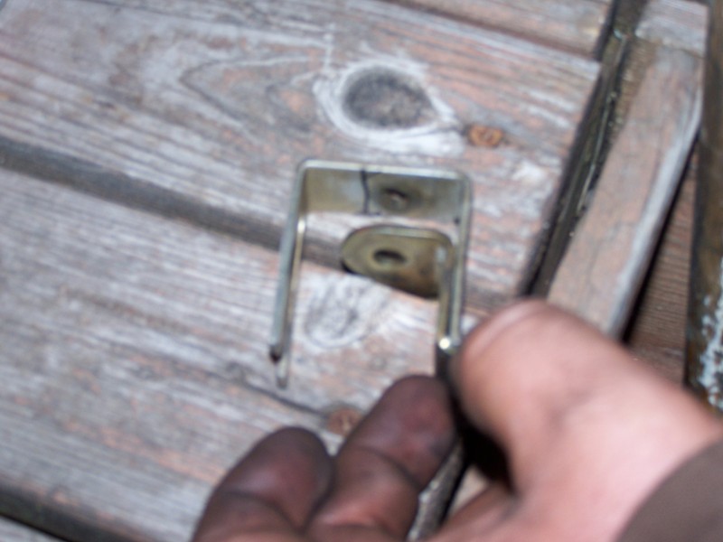

I took the throttle cable bracket off the old carb and had a friend weld it to the linkage that came with the weber. also make sure you get the orientation right on the linkage so when you bolt it back on the new carb the linkage goes on the same as it did on the original carb.(PIC FOUR)

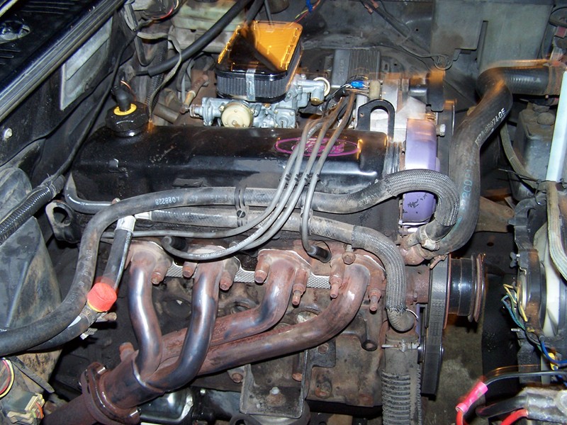

the next step is the hard part you need to cut the tab off the spacer then bevel the wide side of the opening to allow the secondary butterfly to open this can be done with a hand grinder but I had a friend with a bridgeport cut it for me. then with the carb centered over the two holes next to the beveled end mark the new holes that need drilled and tapped on the opposite end of the spacer(I used a gasket instead of the carb to make it easier to mark.Then mark the holes and drill them and tap them it has been a while but I think I used 5/16 hardware.(PIC FIVE)

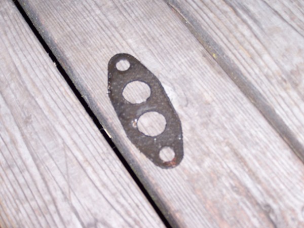

for hardware you need to get 2 studs in the size you tapped the holes. They can stick out the bottom a little bit but they need to be about 1/2" tall on the mounting side so they don't hit the linkage.also don't forget nuts to bolt down the carb to the spacer.(PIC SIX)

when done it should look like the last picture minuse the exhaust mod that I did and hopefully the oil leaks lol.(PICS NINE,TEN,AND ELEVEN)

It's good to see a thorough piece done on a mod like this...So this would be a mod for replacing an 88 Aisin with a Weber for the record right?..and kudos for mentioning the need for a proper pressure reg 4 the Weber. It runs good ? Not many here run a Carb yet but I for one like the Idea of having at least one vehicle around that can run w/o a computer and it's neat to see some interest. I should have a 94' 2.3 block up and running with a Carb and Points Dizzy soon.not sure which head I'll use but economy and power are both good reasons for choice..and of course..Simple...How do you like that header?...looks pretty kewl...
this mod and the new factory header as seen in the picture not only helped mileage but driveability.
I probably gained 10 lbs of torque on the lower side of the rpm scale and lost nothing on the upper end.
saturday I helped a friend move some concrete blocks and the bed was almost full to the top of the bed and it was heavy but I was able to climb a pretty steep hill in 4th gear and still accelerate @ 60mph. so to answer your question yes it runs good. it does take some tuning skills to get it done but if you read the directions carefully it isn't to bad.

BTW, that first pic brought back nightmares...lol...
hey mark was it all the wiring or the really lame splatter paint on the air cleaner.lol
I know every time I opened the hood I got a chuckle.
Well, the breather paint made me take a closer look...lol...but the vac lines/wires...and the old exhaust manifold...must have dropped about twenty pounds of dead weight just with that mod...
now it looks like something people go "Wow" when you pop the hood...:icon_thumby:
That's the reactionI got from many people after similar mods...
