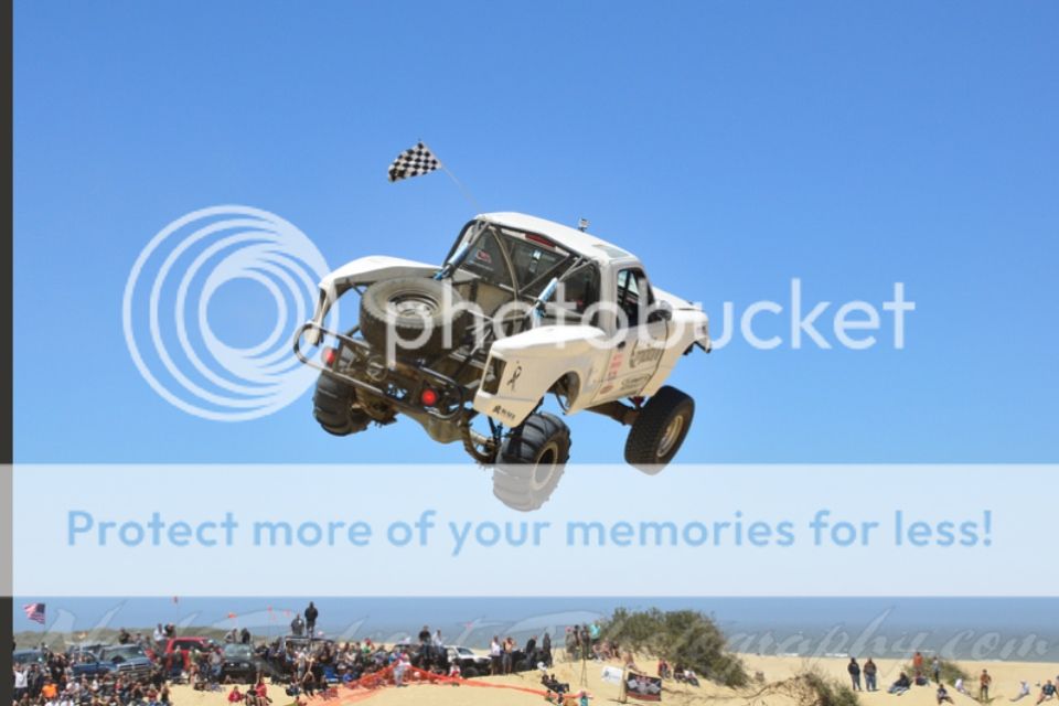

OK, well I decided that instead of a thread for every major mod I make to the ol' Ford, I would consolidate my build into a single thread that I could add too.

took it to pismo:
RaceRangers Build
RaceRangers Build
