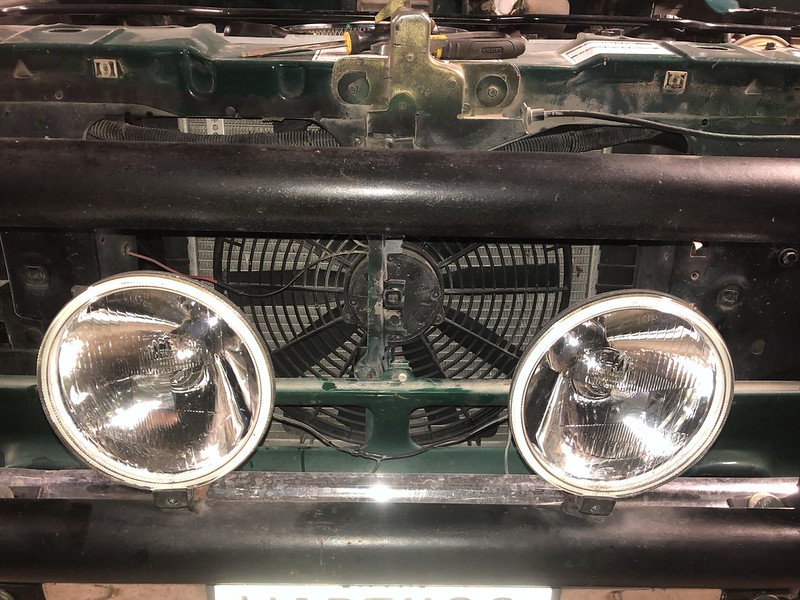

E8TZ-15200-C : 88-92 Fog Light Kit
'85 Ranger Restomod
'85 Ranger Restomod
'85 Ranger Restomod
'85 Ranger Restomod
'85 Ranger Restomod

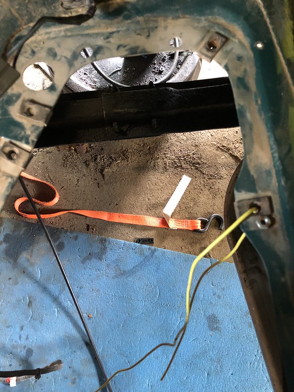

Well, since the dust has kinda settled on some family issues and the weather supposedly cooled of a little (I didn't notice a big difference) I got started on my spring swap.
Brake caliper and shock removed from the suspension...
'85 Ranger Restomod
Suspension sagged and I could finally get a wrench on the infamous nut. Much to my dismay (and I knew somehow it would give me a problem) the whole dang thing unscrewed from whatever it screwed into.
'85 Ranger Restomod
Sooo tomorrow I have to see what that is about and loosen the swaybar so I can get more drop and get the spring out.
Well, luckily it just threads in to the beam from there, and there is a hex on the bottom that you can put a wrench on to extract the nut on the top. They can be a real bitc# once they're rusted on like that. I suggest using some creeper oil, and heating it up with a torch. It should come off fine. I would also get new bolts/nuts for it, or wire wheel the crap out of the old ones.
You also might have to disconnect the radius arm to drop the beam down far enough to access the hex on the bottom.... Maybe not though.
-Denny
I would love to do a v8 swap to mine like yours but I would want a manual tranny though, along with a manual tansfercase.
I can wiggle the beam and see the spring pull away slightly from the bucket, so I am pretty close that way. I think if I get the swaybar off I can get that extra half an inch. If I have to remove the RA it wouldn't hurt my feel bads too much anyway because after this I have to change the RA bushings. With the stud removed I don't have the extra length of that to deal with.
When I get the the stud out, hopefully I can get it apart and bead blast it... and then never seize it. As it is, the retainer is a awesome funnel to surround the nut in crap and never let said crap leave.

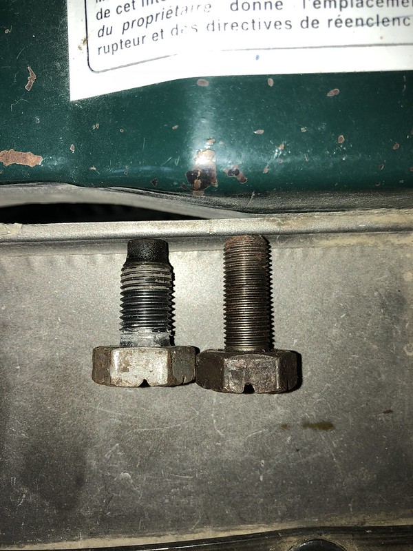

What changed in that stud from '85 to '86?
'85 Ranger Restomod
We attacked it over lunch.
I bead blasted the threads it had left to go, let it soak a little while with penetrating oil. Then dad held the stud up in there with a prybar and had a box end wrench on the nut, and I rattled on the stud with a impact, slowly it came and then once it was on the clean threads it came right off.
The threads look perfect once cleaned, with no torch used to compromise any temper the stud had I am going to go back together with it.
