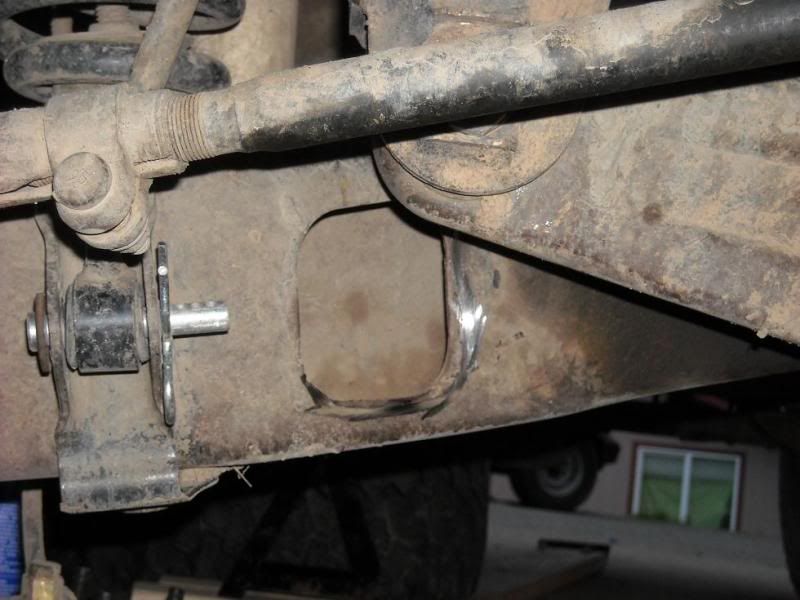

just thought id say! especially when you dont have every right tool. worked on it for 6 hours and the front still isnt done. got the worst of it out of the way though. at least the rear will be a breeze!:headbang:

well what was a pain for me, was you have to grind off 4 rivets holding the drop bracket on the engine crossmember. we got one side mostly off the rivets, then our grinder broke. so we had to spend a while drilling all the way through the rivets.
and when putting it back in, the 2 sides of the axles had spread apart alittle- the easiest fix for that was to strap a come-along to each side and just winch the sides together.
biggest advice though, is make sure you have AT LEAST one helper, but 2 was ideal for me, cosidering we didnt have a hoist nor all the ideal tools.

yeah, we got the grinder up to the bolts, but the grinder motor went out before we were finished, so we spent a while drilling because i was the only one with a vehicle, which was in pieces.
and the bolts on the coil springs were kinda rusty, but we used a good cheater pipe on the end of the wrench so it wasnt too bad
