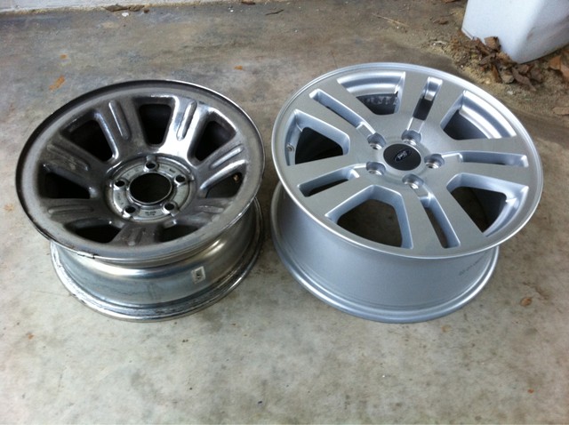

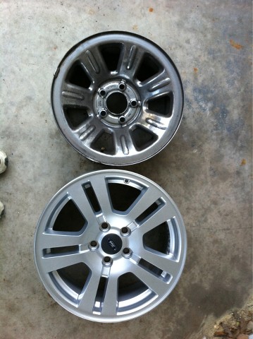

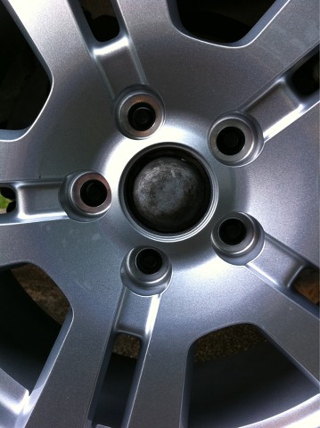

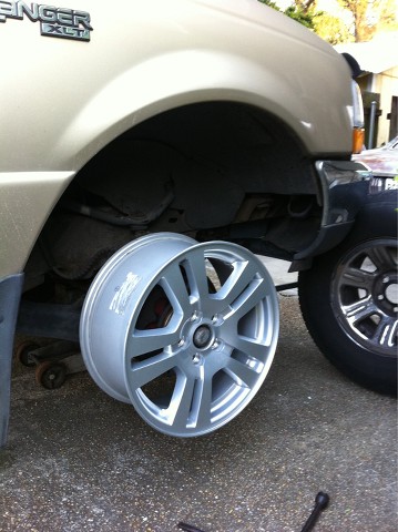

Drop: 2-1/2" rear w/ hanger flip, 2" front with Western Chassis coils
Wheels: '07 Mustang 16" X 7" Base Model
Tires: stock Mustang 215/65X16 BFG's - I plan on a set of 225/65X16 General Altimax HP's when the BFG's are done as the OD of these is nearly identical to the stock 225/70X15's.
Offset: 37 mm
Spacers: 1-1/4" cheapos rear, 1" Eibach front

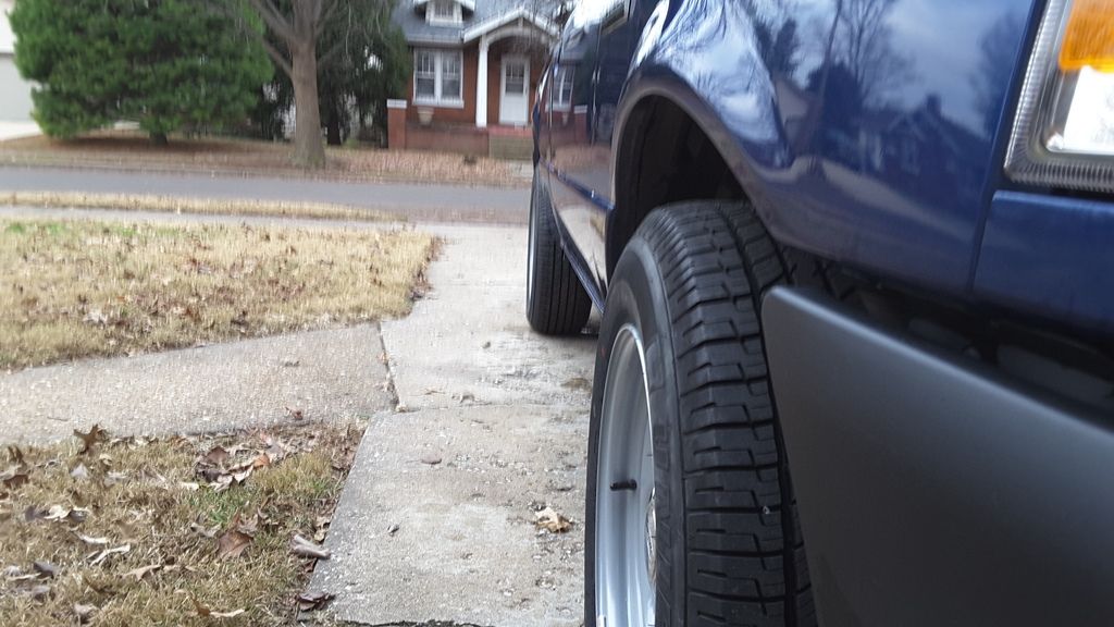

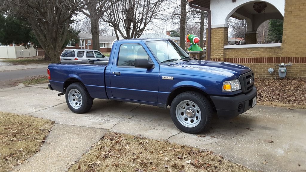

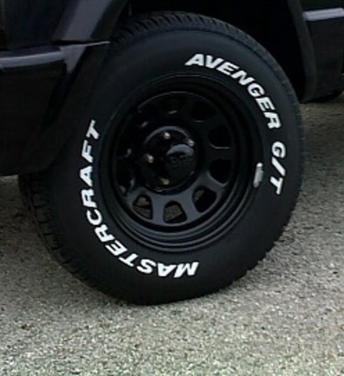

Jeep Canyon wheels w/center bored out to 2.75" for push-through centers
Backspacing: 5.5"
Offset: +25
Photos of different wheel/tire sizes on stock and lowered 2WD's
235/70R15's on STOCK front suspension

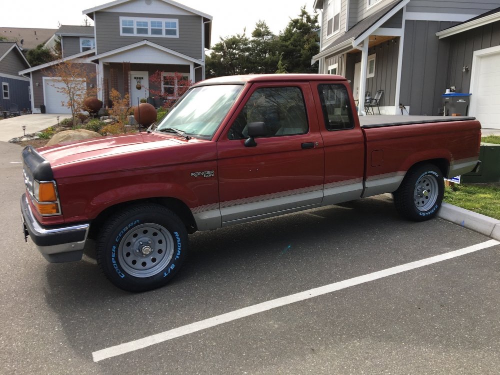

275/60R15's on 98 Explorer 8.8 rearend in stock location w/slapper bars

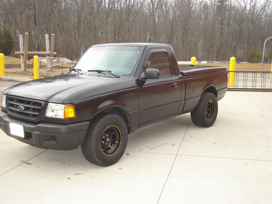

Stock suspension with Ranger Splash 15x7 rims.
Tires are BFG A/T 30x9.5's.
Slight rub on fender liner when flexing the truck (like on my 30 degree angle driveway:annoyed:).

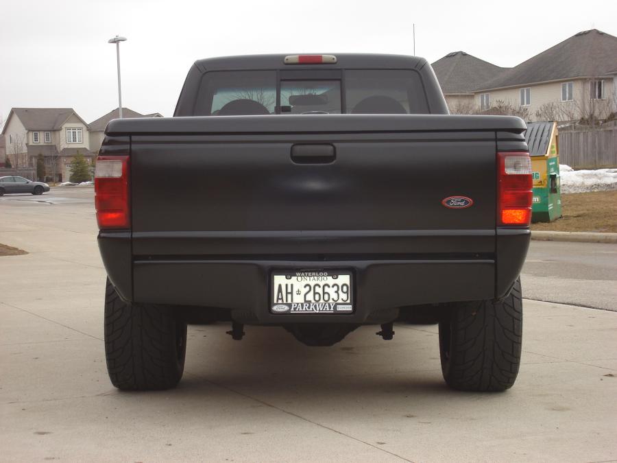

Eagle Series 192 alloys, wrapped in Nexen N3000 rubber, Sized at 245 / 45 / 17.
Warning. These do rub at full lock.
Also, had to mill the centre of my front rims to allow them to fit over my hubs.
Stock spring sag and ranger lean.

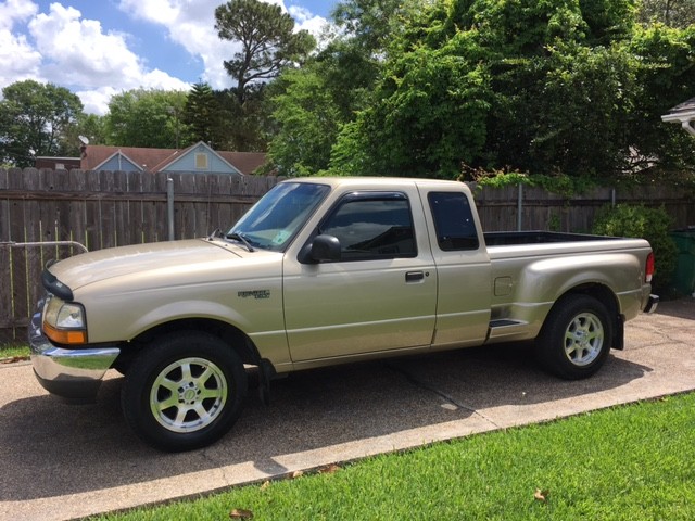

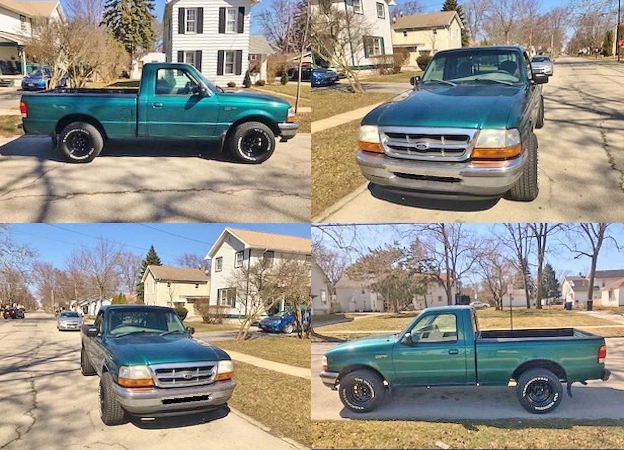

Stock '97 Ranger
tires are 255/70/R16 (30"/10"/R16) and the rims are off of a '98 Explorer.
