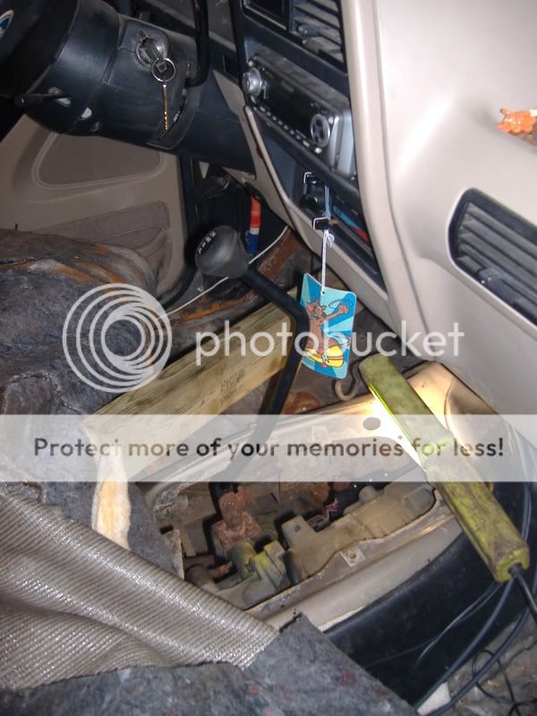

I will have to get some pictures posted up for you. If you want to use a ZF you either need to install a body lift or fab a new trans tunnel. It will not fit nicely. I put a body lift on and I still had a spot that was pretty tight. You need the engine to sit as low as possible in the frame too. The shifter will need to be modified and the stock ranger boot won't work. It will be pointed toward the dash. I used an NP205 for stregnth and it happens to be smaller than both the NP208 and BW1356. With the NP205 you will need to grind a passage for the shift rail to clear on the tailshaft housing. The stock speedo stuff will work. If you decide to use a ZF it will be in your best interest to install the engine and trans already mated.

I will have pics today. The ZF shifter comes out pretty close to the dash. I cut and rewelded the bottom of the shifter where it bolts to the trans to fix this problem. If I didn't 1st, 3rd and 5th wouldn't be used. I forget the exact years of the NP205 but you are pretty much guranteed to see it in a 70's 4x4 Ford. The era is late 60's or so to the early 80's. It's very common but be sure to read the ID tag so you don't get a NP203. They are quite massive. The T5 setup the shifter comes out right in front of the set. 2nd, 4th and reverse will just hit the seat.

Excuse the mess in there I need to get my wires looking nice yet; I just moved the MSD from the engine bay to the inside. Here are some pics.
Here's 1st gear

Thanks for the pics. So, does anyone know if on a 95 are the firewall to stock shifter dimensions the same as an 88? Body lift makes sense. I'm putting one on currently. But why not help by cutting that massive semi-triangular tab off?
I would believe those measurements are about the same. Maybe a little less room because that dash is bigger. The big tab on the trans isn't the only part that hits just the one that I can snap a picture of. The bellhousing is massive and the top of the transmission is massive.
