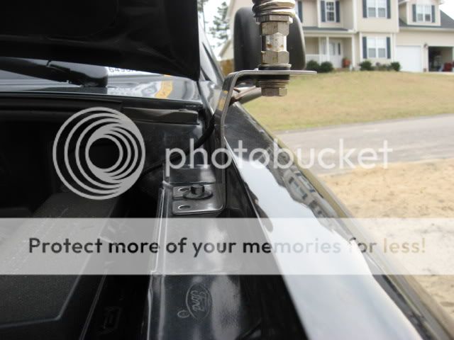

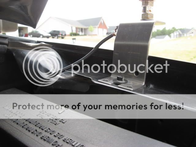

Here's my mount Mike. It's the same as Shane's (FX4wannabe01) except mine isn't cut down like his is. I can get a better picture if you'd like.

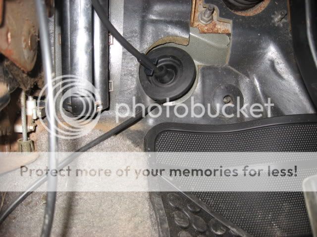

To get my coax into the cab, I ran it through an existing rubber grommet in the floor. It's right behind the door and there's one on both sides of the truck. I mounted my antenna in the driver side rear stake pocket.

That is a great idea for a mount :icon_thumby:! I am doing the same dance around my truck trying to figure out where to mount mine.
I would love to see some pics with the hood up.
Also i didnt see a coax coming out the bottom of ur antenna?

In that picture, I was waiting for the coax and CB to arrive. I had the mount and my old antenna so I installed it. I will take some pictures with the hood up so you can see where I routed my coax.
Some more pics would be killer Tom. I'm trying to find the mount that Shane has but do you know where he bough it from?
I don't remember the part number but he said it was for a 99+ F250 IIRC. I bought mine from him. He cut his down so it's not as big. I left mine "stock" so it sticks up a bit. I'll take some pictures tomorrow morning so you can see it better.
