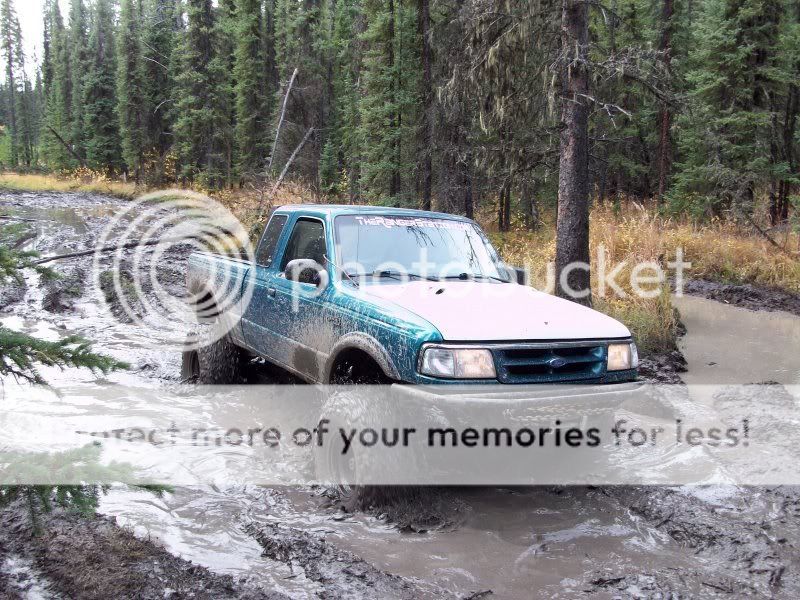

Well I guess I can show you a pic of mine for reference, but if you want a winch be sure you watch the weight on making a bumper. Once you make a bumper and add a winch to it your looking at some pretty good weight on the front end. That is why I don't have a winch in my bumper, going to wait until it's not a DD to put one in.
Weight on mine isn't too bad, about 200lbs between the winch and the bumper.
