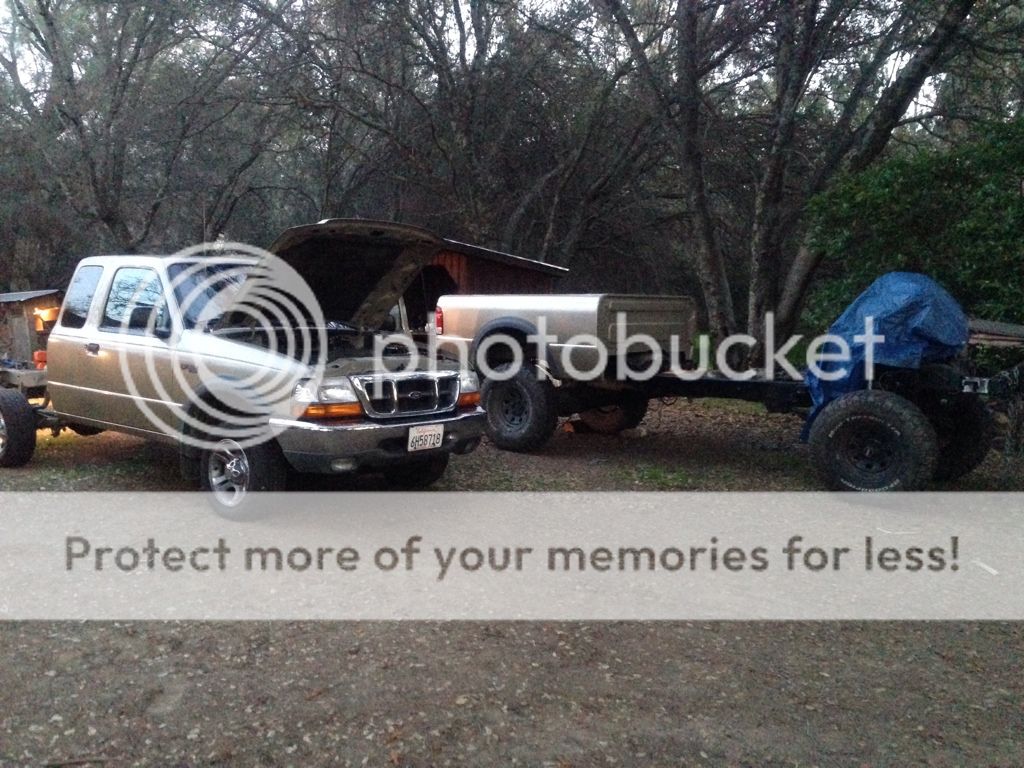

I chose a donor Ranger that was very similarly equipped to my then current 1996 Mazda B-4000. I bought a beater 2000 Ranger with straight sheet metal and decent interior. It had the 4.0L V6, automatic tranny, and electric shift t-case. It wasn't identical though so that is why this particular swap was difficult. I had to retain the interior electrical harnesses and dash harness (but didn't want to swap dashes since then my interior would be two tone beige and grey). I recommend getting a donor truck with the same color interior. That would have save a lot of time and headache.
Donor truck:
Truck I was swapping to (because I rolled it):

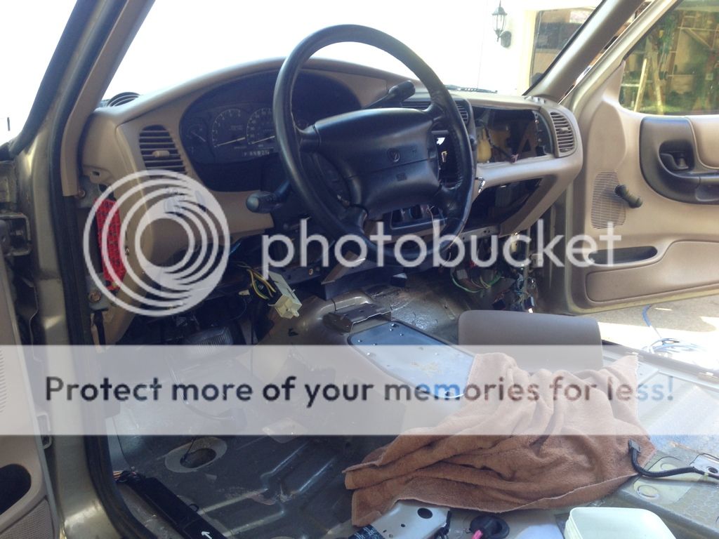

Remove dash. Google search on how to do this, there are some good articles out there. It is quite involved but not very hard, just tedious. I won't cover that here.

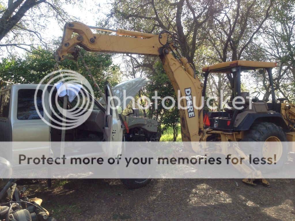

Remove cab (heavy equipment makes quick work of this):

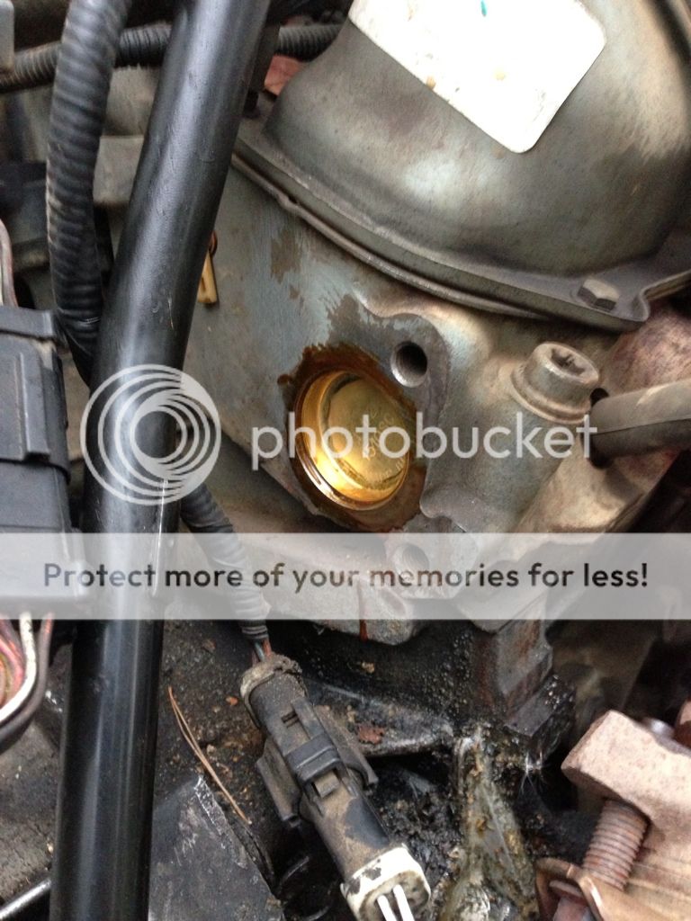

Once the cab is off you can remove the bed at anytime (or before, up to you). Now is a really good time to do spark plugs/wires, oil change, steam cleaning, painting, body mounts, freeze plugs and/or tranny/t-case fluid changes. I highly recommend doing all that you can while you have the access. You won't ever have that amount of access again most likely!!!
Freeze plug replacement access:

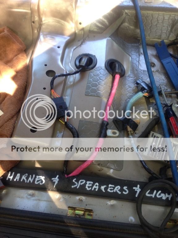

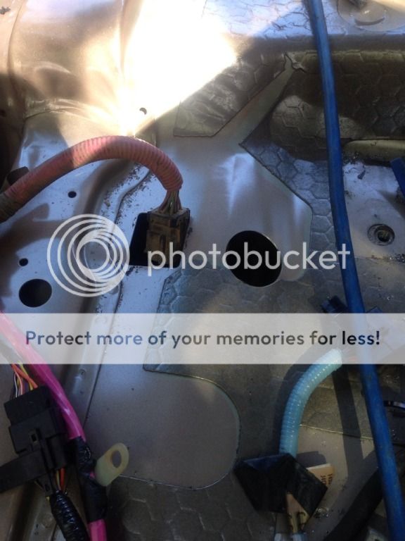

The 1996 has two bundles of cables going through the floor on the driver's side, in round grommets.
The 2000 only has one and its square...
...Have to cut holes in the new floorboard if you retain the older wiring setup. Easy fix with a 2" hole saw. Plug the grommets in and you are good to go. I siliconed the grommets in.

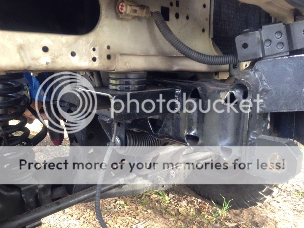

*Bodymounts:
The front two have to be spaced out ~1-1/16" per side wider than existing mounts. I cut off original mounts and welded on 6" c-channel. Use whatever is convenient. Set cab on new bushings right on new supports, mark, lift up cab and cut holes in the supports. Make sure that cab is square with frame.

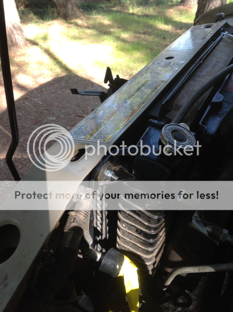

*Radiator Support:
Passenger side mount on new cab-body has to be modified and moved over or extended about ~3.5". Drivers side ~2.5". I used flat bar welded to the top of the brackets after grinding out the lip. Sorry no pictures. Retain rubber mounts.
2000 Radiator & Condenser too wide to use on TTB Frame. Had to retain the 1996 radiator and condenser, due to the frame rail width being to narrow to use the 2000 stuff.
Condenser upper bolt holes work.
Radiator bolt holes do not. Make two brackets. Drill two holes in each. Weld a stud in one. Paint.

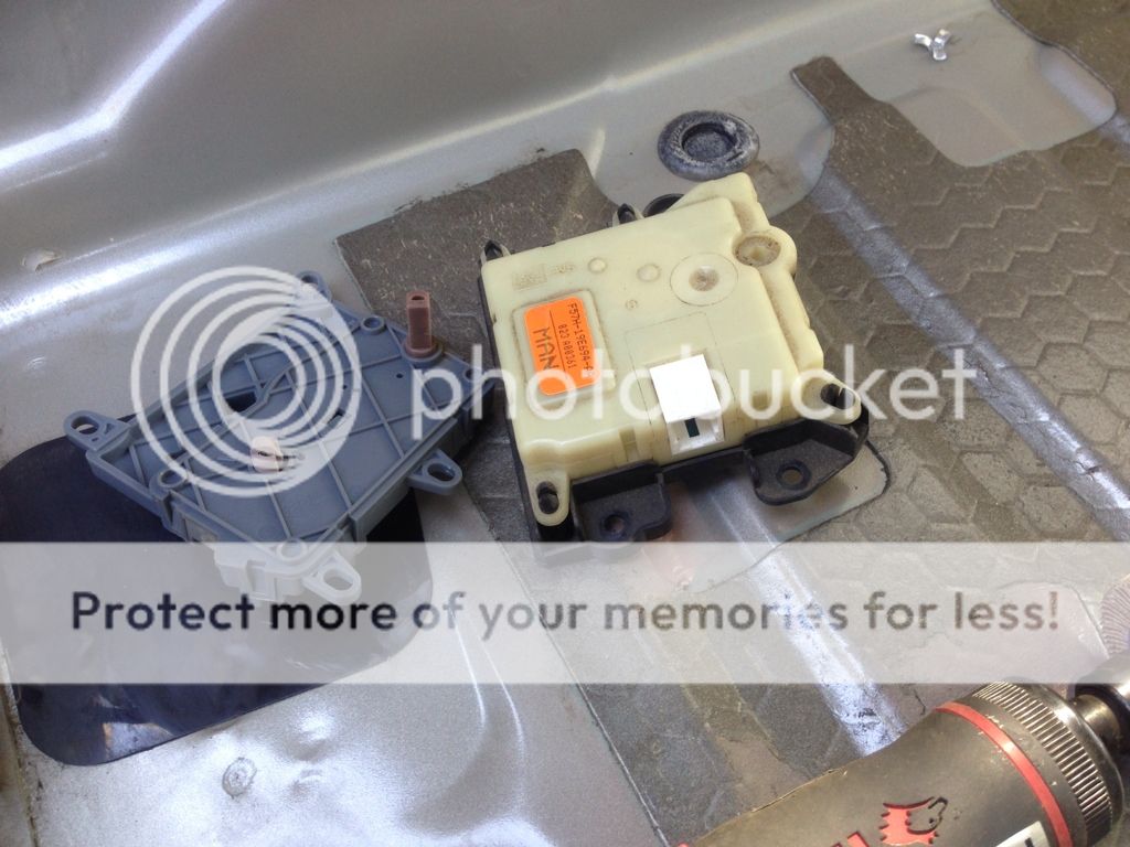

*Heater/Cooler blend knob:
1993-1997 used a electric motor for the blend door. 2000 used a cable type setup. If you retain the HVAC blend box heater core assembly out of the NEWER cab like I did, and want to retain the electric blend door motor out of the 1996 cab. Do the following. Remove the cable actuator, grind the tabs off of the HVAC box, and mount the electric motor to the HVAC box using the original hardware.
Cable actuated on the left, electric blend motor on the right:
Mounted:

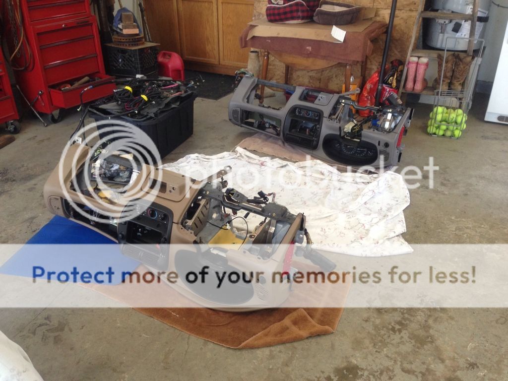

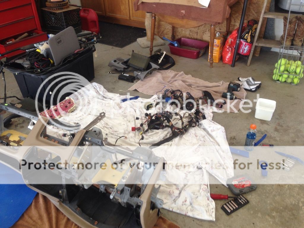

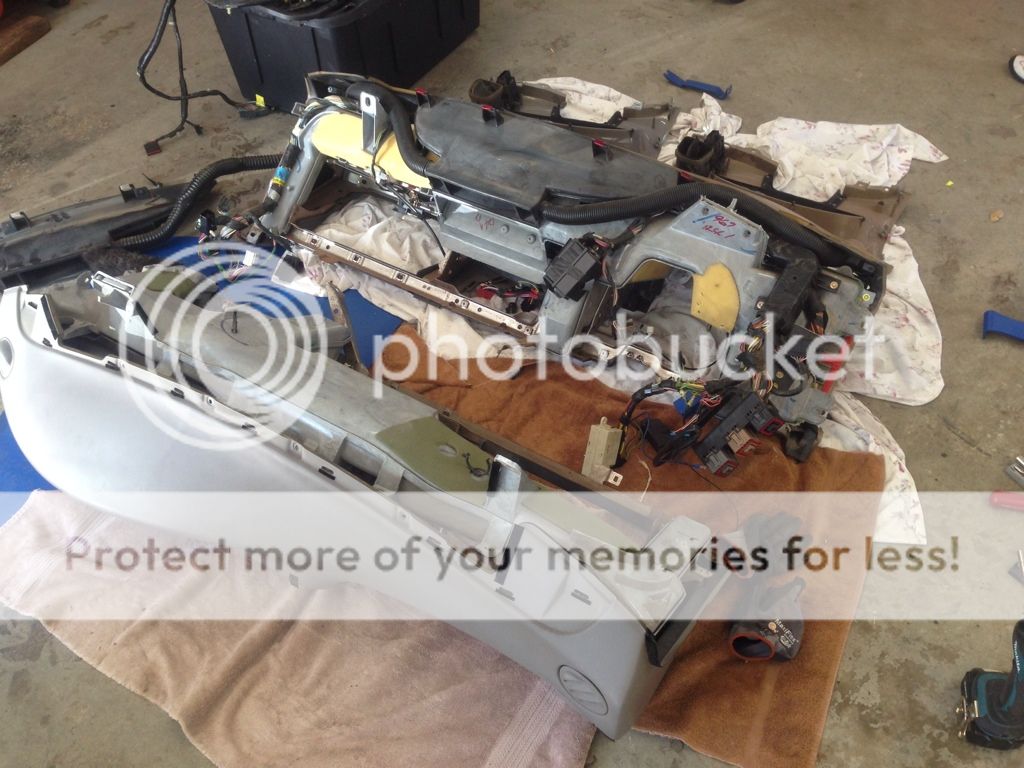

Now set dashboards side by side and swap the dash harness...not hard just tedious and take your time. Take a few pictures to aid your memory of where all the bundles and clips go.

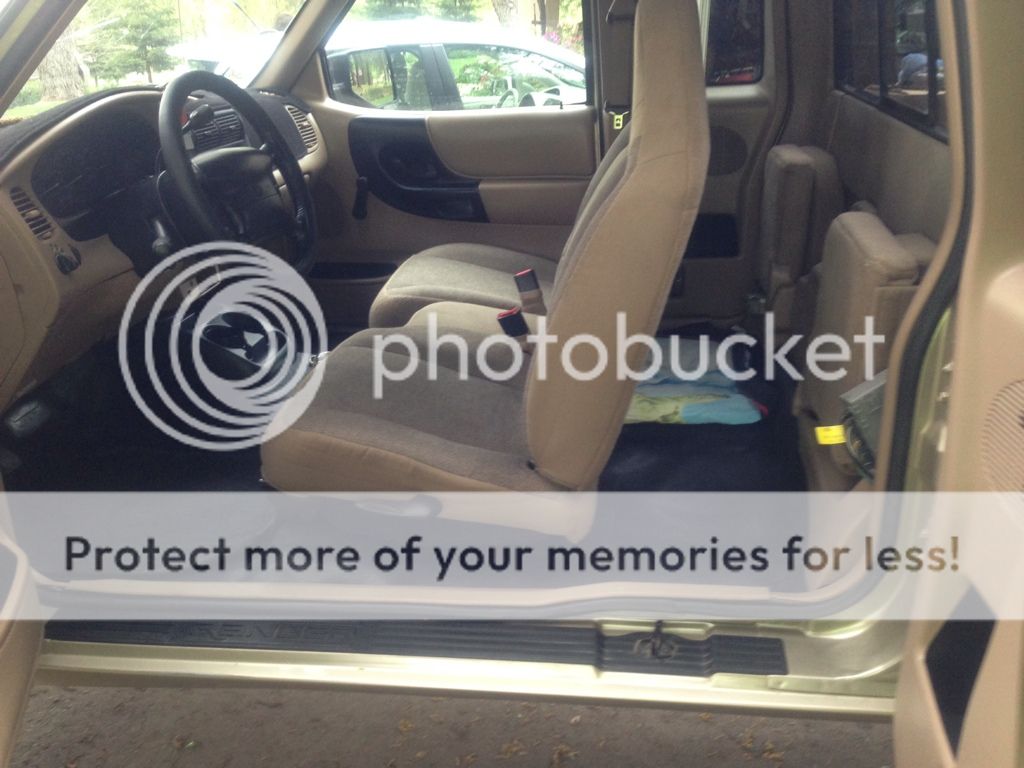

Reinstall dash.
Reinstall interior.
