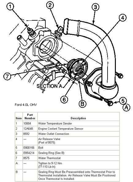

The only other thing i could think of is timing but that wouldnt make sense because it doesnt do it when its cold. As for the gauge, there are two sensors, one for you temp gauge ( passenger side, on top of the thermo housing ).
The other is a two wire for sending the temp to the computer for air/fuel ratios (same area just about 5 inches to the right on top of the thermo housing under the throttle body). Not sure if u knew or not but to clear any confusion i thought i would just let you know.
Added an image as well. I just like to be thorough.

Well, I replaced the "Water Temperature Sender" this morning..... Not sure how to put this but most of the popping has gone away... It only pops now if I stomp it. It pops ones or twice, and there not as loud too. Ill disconnect the battery to reset the ECM and hopefully that will clear up the rest of the popping.
