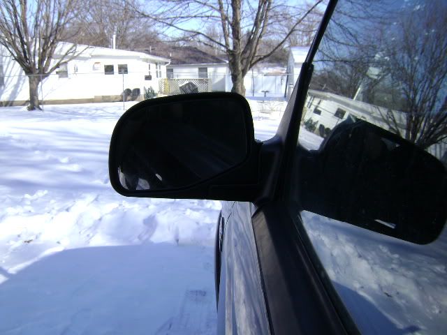

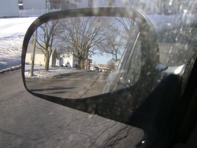

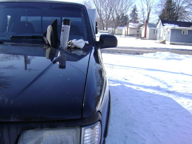

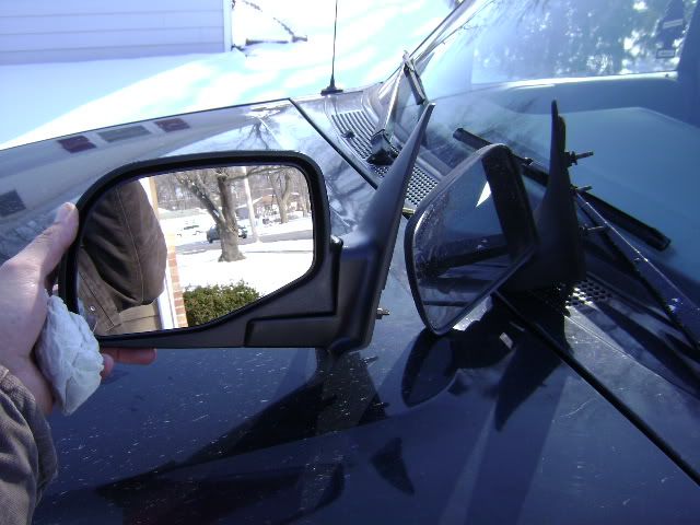

Had a chance to jump on these for cheap new (rock auto). The pictures should speak for themselves. The newer ones provide a much better view! I noticed the old flag style ones didn't actually provide a whole lot in view after a my friend pointed it out, so this is how I fixed it. I know the newer 07' mirror mod is in the tech library, but I actually prefer the black plastic to the chrome.

I love these, makes merging and switching lanes less of a head whipping event. This will also help when towing, or hauling a load!:icon_thumby:
Bolt on application from a 2002 Ranger w/ manual mirrors. They also fold to the side easily for clearance.

06+ Mirrors can be put on gen III+ Rangers with minor modifications though.

Lots better!

Comparison:

They go on Ebay for 60 bucks a pair. I picked up a set for 30 bucks at a junkyard. They are power, but they can still be adjusted manually if you dont want to go through the hassle of wiring them up.
They will bolt right up to any 93+ Ranger. The only mirrors that require modification are the square 06+ Ranger mirrors, which if I remember right you have enlarge a bolt hole on the door and use a few washers to shim up a bolt.
