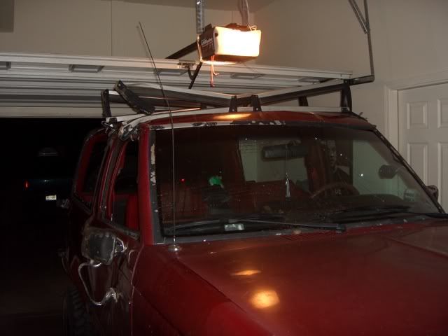

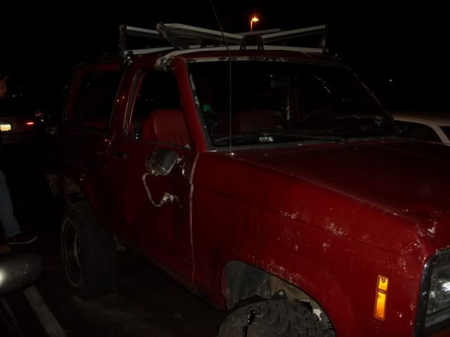

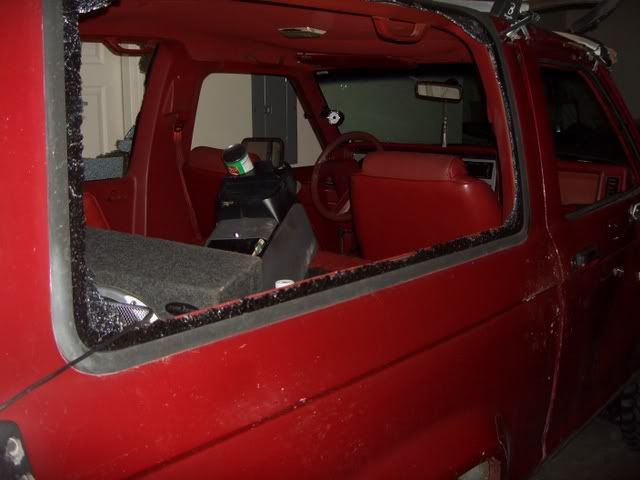

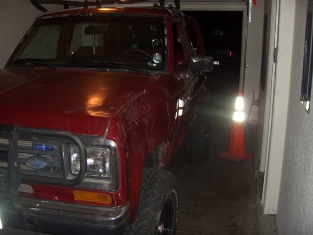

i hate to ask but do ya have any pics of the damage and after it was chopped?

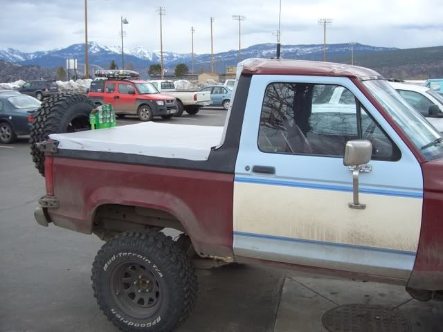

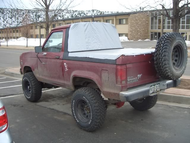

The silver tarp is there untill i get the roll cage.
I herculined everything inside and up over the bed rails
I have a huge roll of softop fabric and plexyglass for a rear view window
FYI, in some states if you put in plexiglass or some other more rigid divider behind the front seats of a choptop BII you're required to register it for truck plates rather than as a car, which increases insurance and registration fees. I say this because that was my original plan with my choptop and I had to change my idea around some. I think my new idea holds promise though, but I'm not sure how I'm gonna go about getting a top for it, the local place that does boat covers an the like wants $550 to do just a partition piece from the roof down halfway and more if I want to do a bedcover too. :wtf:
Yea, mine flexes like a wet noodle too when I get off-road. I had thought it was cuz I lost a frame crossmember in my build but I guess that's not it....
Yours looks like its coming along pretty good though! keep up the work.
