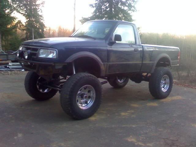

Its done and driving, I love it. The 5.13s are great, I can cruise in 5th gear now everywhere. I will get more pics later.

It is sitting high in the front, I need to take out about 50psi, Then it wont look so huge. The pics make it look bigger than it is, but it still isnt little.

2wd :taunt:
them are some awefully shiney wheels. looks soo clean with no springs under it. you gonna carry nitrogen tanks on board so you can adjust them on the fly?

Thanks for pointing that out wicked:thefinger:, lol.
I gotta get a driveline made for the front. It wont go at enough angle to let the drivers side go to full drop. I probly wont carry any nitrogen with me but I will get the kit they sell later so i can adjust them at home.
=BeaterMan nice! how ya liking it?
I love it, its great. Rides very nice, but it does tend to lean a little, but oh well. Its not bad enough to make me put sway bars on it:D

The first time in awhile i've seen an RBV flex better in the front than the back, nice work. :icon_thumby:
I was thinking exactly the same thing.
The truck looks incredible, and I cant believe how little is under the front end, it looks wrong almost, kinda naked like.

what do you do for brake lines witht hat thing...is it like the rear except with flexable lines at the knuckles?
How does it drive down the road with the air shocks?

I had brake lines made for it. Im running extended lines off the stock hard lines in the front and an extended one in the rear. The fronts are 33" long and the rear is 25". It drives pretty good, it is very soft in the front I love it. It rides like a Caddy.
