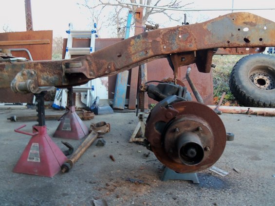

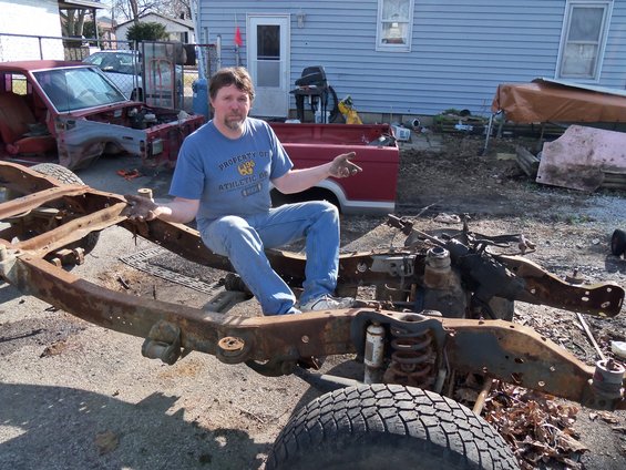

I have officially started my (and my wifes) Ranger Rebuild here is the General plan:
1. It will be Red
2. It will be 4x4
3. It will stronger than before
4. It will an automatic (probably)

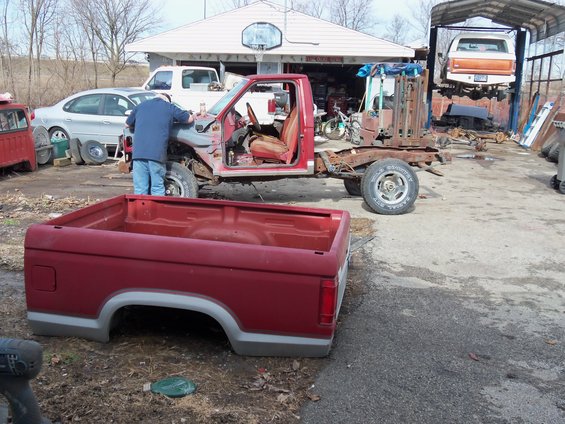

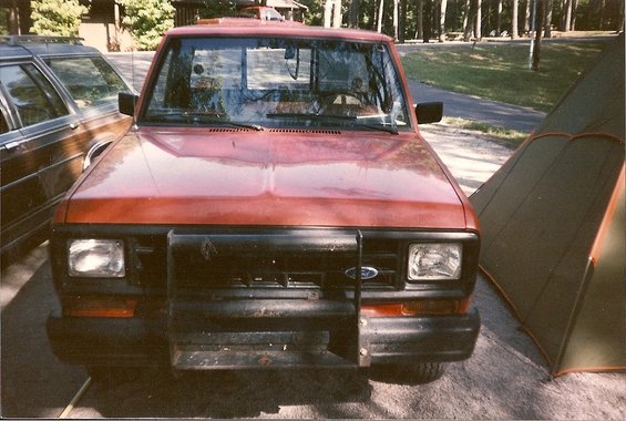

This is part of the before picture the cab that will be on it is not this one.

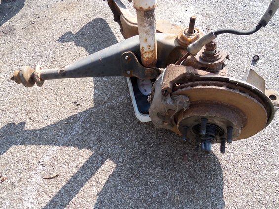

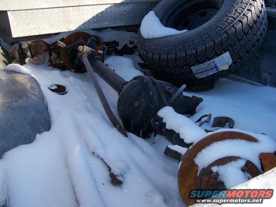

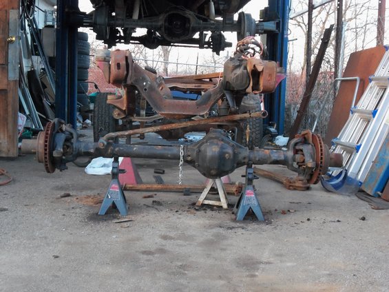

79 D44 hi-pinion full width
Huggyb1972's 87' Ranger 4x4 build
Ford 8.8 trailing arms with a Y-link out back.

As for my truck I have some off the wall plans for it and to start off I am going to beef up the frame by adding plate to box the c-channel for rigitity.
I am wondering how air bags would work off road for this deal instead of coils springs has anybody tried them? how did it do? I would like to be able to change wieght bias and possibly make it kneal so Dad doesn't need to jump as far.

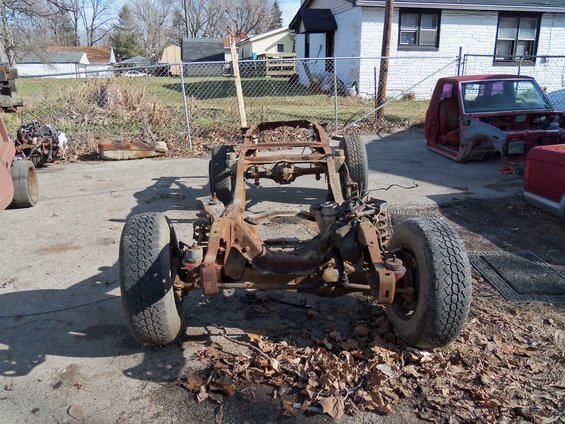

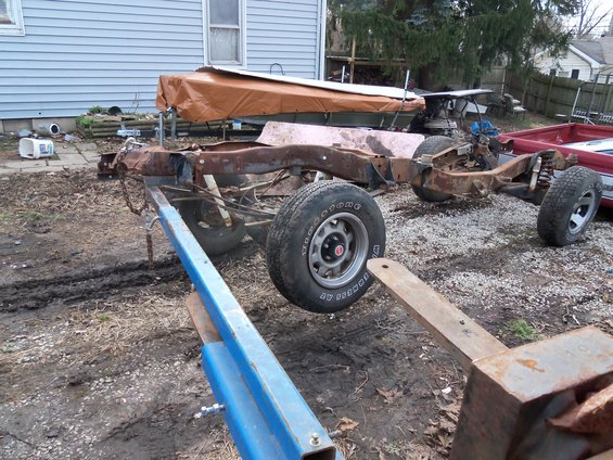

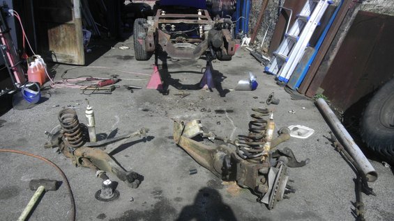

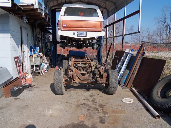

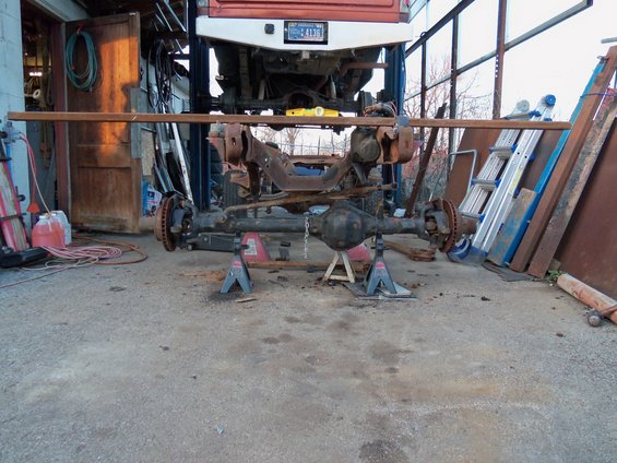

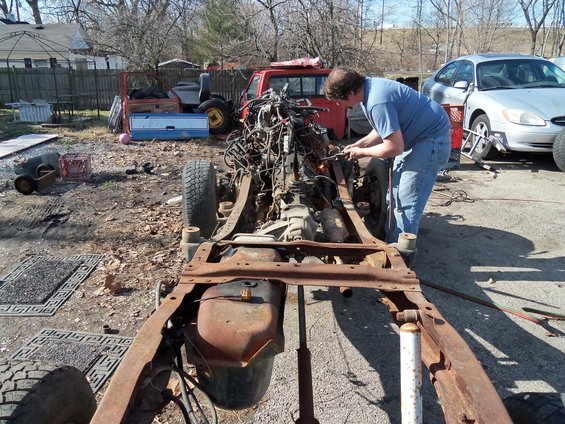

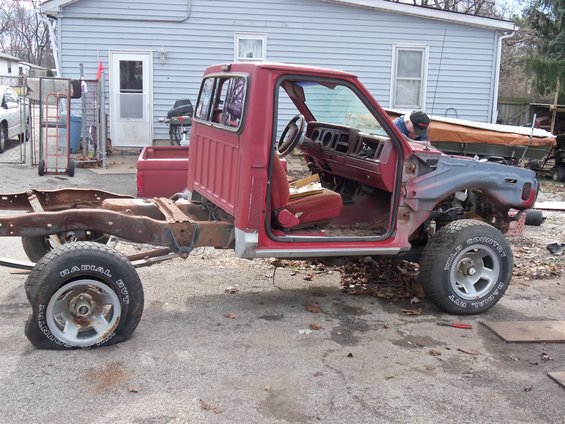

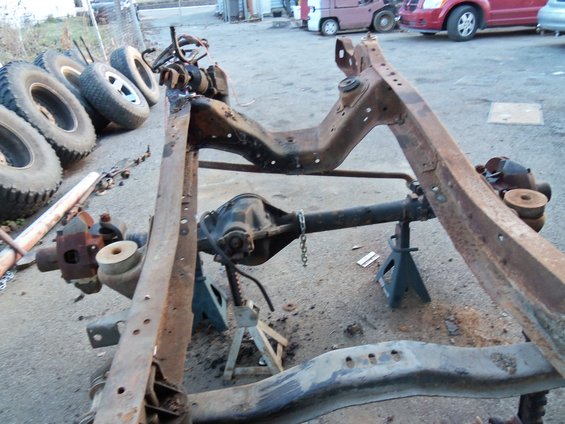

Finally started the teardown process cab, bed, and driveline alll got pullled out.
There's always one bolt that won't come out normally

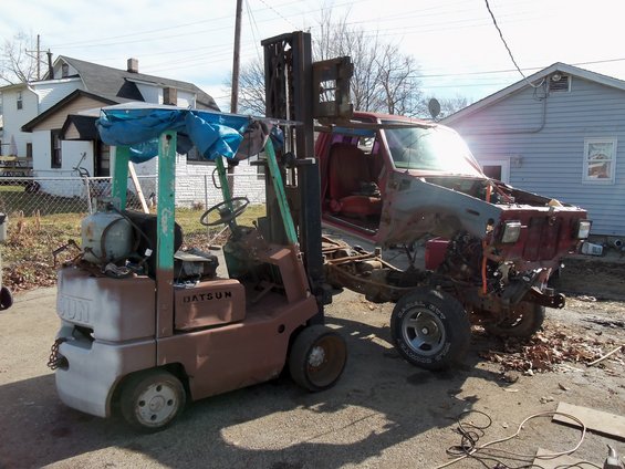

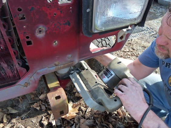

Fork lifts are very handy I recommend one if you have the means.

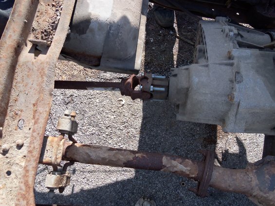

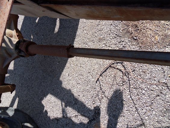

Awesome high angle driveshaft

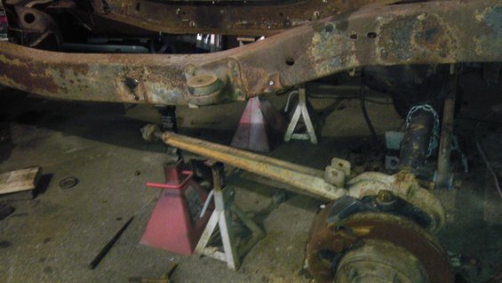

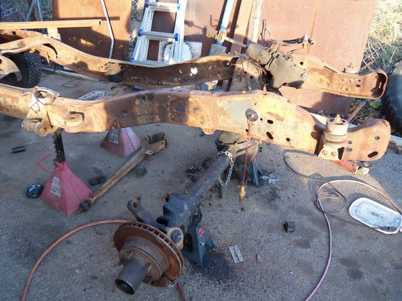

Man these frames are flexy but not for long

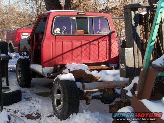

This is the only picture I have of my truck as I remember it back in 92'

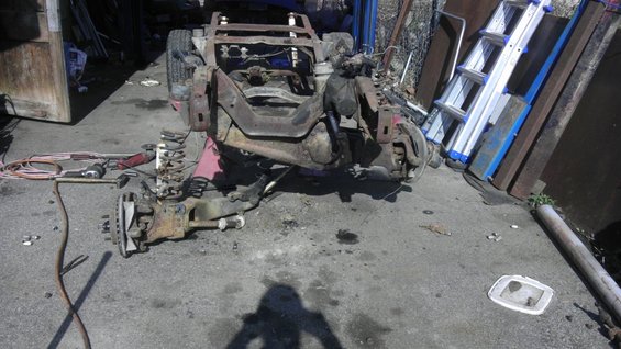

Day two begins the front end work

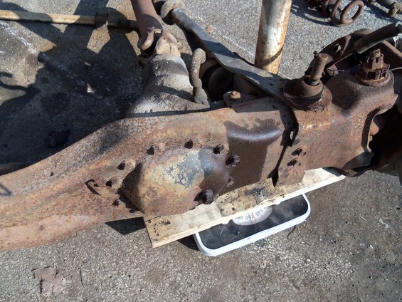

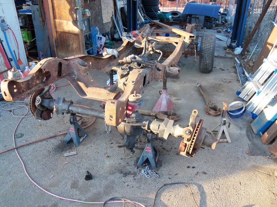

Ever wonder how much a Dana 28 weighs

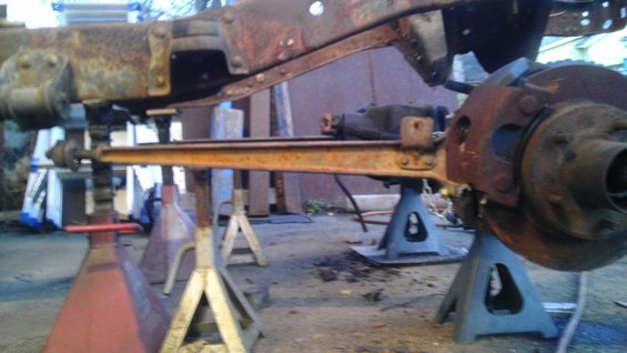

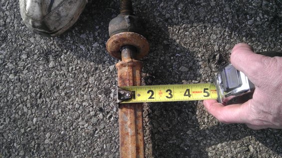

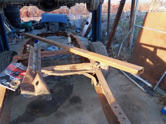

Long radius arms on the front. Got a piece of 3"x1 1/2" 11ga rectangle tube and heim adapters from Ballistic Fab

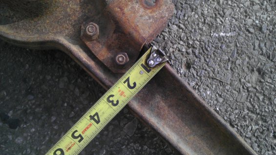

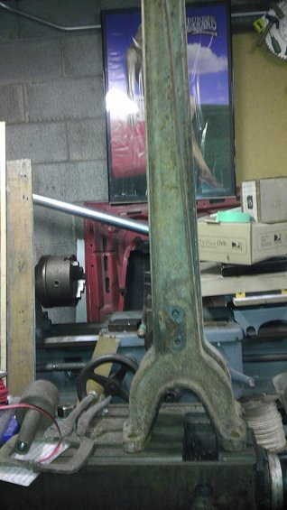

Ran into snag number one the radius arms didn't line up the same when I sat them up on the milling machine table.
The faces of the arms are not machined the same I don't know if these were worked on or made like this. Oh well I figured out how to fix them so the building will continue.
