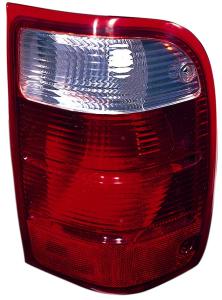

Above is the 2006+ taillights. It has an empty chamber below the reverse light. Since its a separate chamber, you can drill a hole to put a bulb in and it will work fine. This way you wont have to convert your (3) bulb system into a (2) bulb system. 2001-2005 Taillights:
Above is a 2001-2005 Ford Ranger taillight. As you can see it only has (1) bulb for stop/turn and running lamps. There isn't an empty chamber to add a hole for the third bulb. If you make a new hole for an extra bulb, one of them will out-light the other one since both bulbs will share the same reflection chamber. In order to add the 2001-2005 taillight you'll have to convert your (3) bulb taillight system to a (2) bulb. Click HERE for more information. Additional info from forum member shane96ranger: I just put tails off of a 1998-1999 on my 1996. They fit fine, but it was a snug fit. The amber section is on the bottom of the 1993-1997 tails, and at the top on the 1998-1999 tails. I had to persuade my harness a bit to get the amber portion to be able to reach a few inches higher, but it worked after I jiggled and tugged a bit. Thanks to: Ranger Sport Honduras - photos and explanations of the various taillight years. nate09 - For submitting photos of his 2000 taillight swap. shane96ranger - comments
