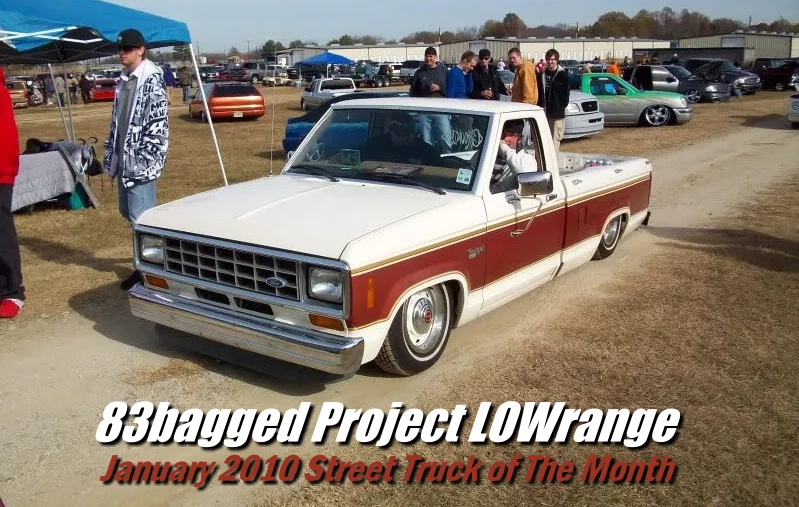

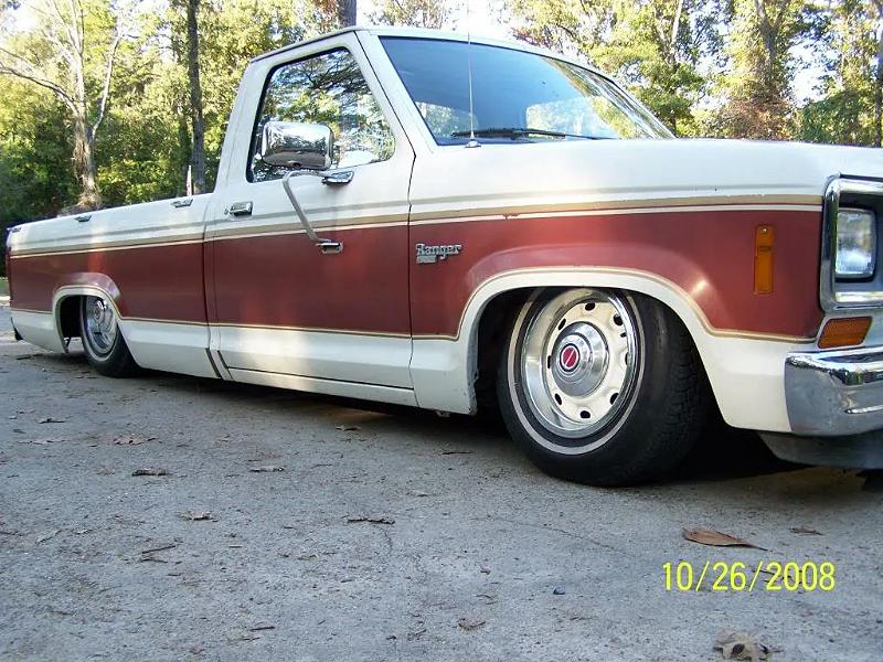

This Ranger has some pretty cool & unique features. I love how it uses steel wheels and hubcaps to give it a vintage stock look.

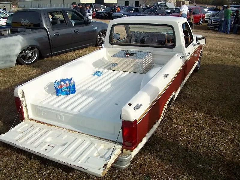

The body has been dropped over the frame so when you open the tailgate, it's not going to open flush with the bed floor. On this build he cut out a factory stamped 'FORD' panel from a tailgate incorporated it into the filler panel to give it a factory look.
This Ranger is unique enough that the members of our forum voted it the January 2010 Street Truck of The Month.

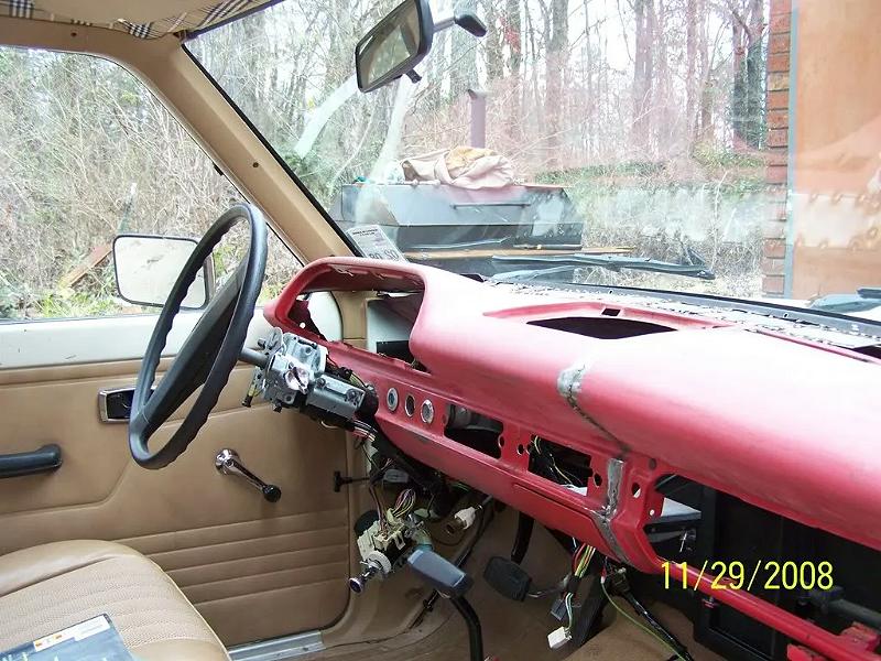

  • 1964 Ford Galaxie Dashboard

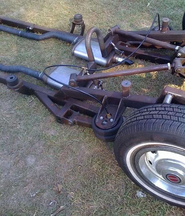

  • 2x3x1/4" Steel Frame
  • Rear Triangulated 4-Link
  • Airbag Suspension
  • Drives With a 4/5 Drop When Aired Up
  • SN95 Rear Discs
