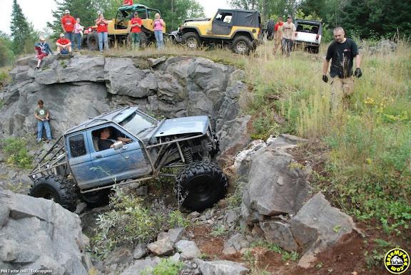

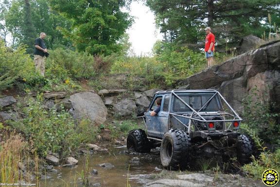

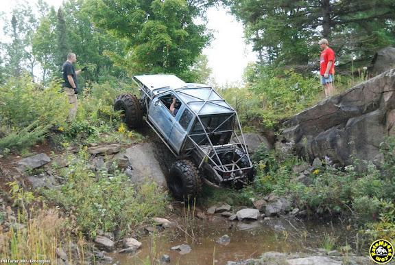

D. T. STARR
1990 Ford Ranger 4x4
Specifications:
1990 Ford Ranger
120” Wheelbase
Front Axle About 10” forward
Rear Axle About 16” Forward
19” Cut Out of The Frame
44” TSLs on 15” Rims
1992 Ford Mustang 5.0L with Some Bolt Ons
Mildly built C6
KluneV (4:1)
NP205 Transfer Case
Ford king pin Dana 60
Moser inners
Yukon outers
Long fields
Detroit locker
Axle Narrowed to 62”
Custom front three link with tracbar
Lowers 46” long
2.5”x 3/8” DOM with 1-1/4" Evos
Upper 46” Long
2.25” x 3/8” DOM with 1” Evos
Early Bronco 24” coil springs
Dana 60 Rear
35-Spline Yukons
Spool
Skyjacker 6” Lift Leaf Springs
1410s at the axles and 1350s at the T-case.
