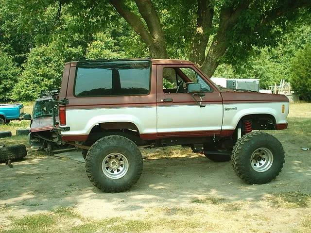

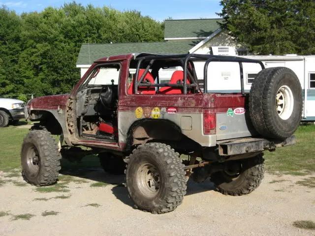

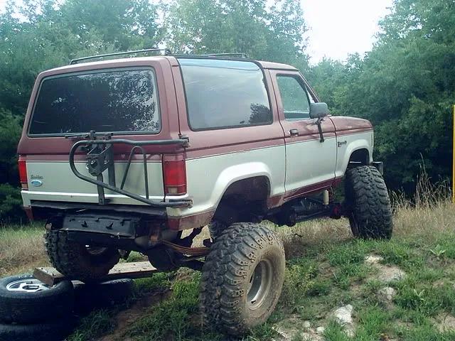

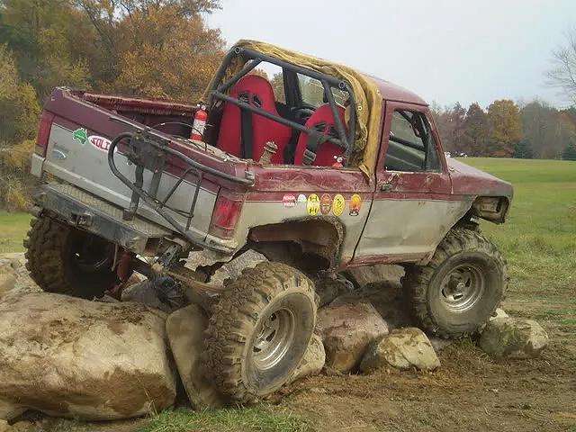

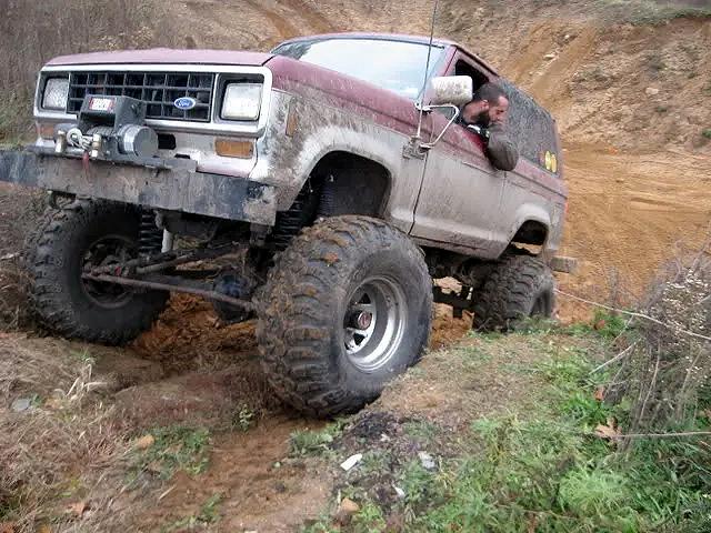

Build Specifications:
Body/Frame: 1987 Bronco II Body with Custom Chop Top, 1986 Bronco II Frame
Interior: Dash, Seats, and Electrical system from a 1991 Explorer, no carpet, Custom Roll Cage
Engine: 1991 Explorer 4.0L
Trans: 1993 Mazda M5ORD-1 5-speed
Transfer Case: BW 1354M
Axles: Front 1977 F-150 Dana 44 with the passenger side cut down to Early Bronco Width (6" Removed) with 4.88 Gears and Aussie Locker. 1975 Chevy D44 Flat Top Knuckles, Caliper Brackets and Spindles. Ford D44 Rotors and Hubs.
Rear Axle: 1993 Explorer 31-spline 8.8-inch with 4.88 Gears and welded spiders and 5x4.5 to 5x5.5 lug adapters/spacers
Front Suspension: Leaf Sprung SOA with a Bastard Leaf Pack and Stock Rear Bronco 2 Shackles moved to front, F250 Shock Mounts.
Rear Suspension: 4" Lift Blocks, 4" lift Springs, and Belltech Lift Shackles.
Brakes: Front 1977 F150 Disc Brakes, Rear 1996 Explorer Disc Brakes
Wheels and Tires: 36x12.50 Bias Ply TSL's,15x8 Steel Rims and 3.75 BS
Misc: Custom Front and Rear Bumpers, 8,000 lb Champion Winch, 3" Body Lift, Custom Tow Points Front and Rear, Removable Doors and half doors.
Award: October 2007 Off-Road Truck Of The Month
Off-Road Truck Of The Month Award
Like many off-road vehicles, the CheapThrillB2 Bronco II went through numerous changes and eventually ended up as a chop top.
