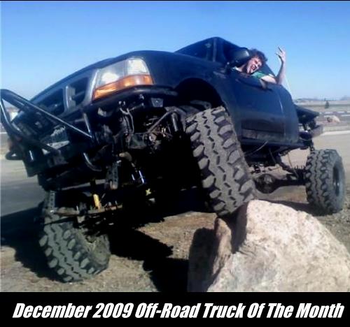

LittleBigFoot
2000 Ford Ranger 4x4
Specifications:
Front Axle
Full Width HP Dana 44
Molly shafts
4.30:1 gearing
Open differential
52" Chevy leaves with 8" shackles
3/4 ton ford van power steering box
1 ton TRE's
Home built high angle drive shaft (tom woods can eat my shaft)
Home brew shock hoops
Warn lock outs
Rear axle
31 spline Ford 9-inch
Molly shafts
4.30:1 gearing
Open differential
63" chevy 1/2 ton leaves
Belltech shackles
2" block
5/8 U-bolts
Cantilever shock system
Home made drive shaft with 1350 yokes
Tone Ring is a BMX bike gear tacked to the pinion yoke with a bracket for the VSS
General:
Around 8-inches of lift
35x15r15 Super Swamper LTBs on gnarly offset stock 79 Ford Bronco Rims
82" track width (out side of tire to outside of tire)
112" wheel base
Measured at 22" of wheel travel front and rear
Tube stinger bumper made of .120" wall, 1.75" O.D. HREW with front receiver hitch
Home brew rock sliders made of .120 wall 2" O.D. HREW
33 gallon fuel tank from a 84 bronco massaged between the frame rails
Custom home brew "flat bed" made of 1.75" O.D. .120" wall square stock and diamond plate
A few spare tire carriers
Cobra CB with 48" antenna
Ammo box center console
Rubber undercoated floor with drain plugs
Fried the rings in my 3.0. Pulling the 3.0 currently, and am building a supercharged 408 or 427w w/ a C6 trans. Still dealing with transfer case options. Trying to rig up passenger drop to run a Chevy Dana 60 (cost) Looking at a NP203 range box bolted up to a pass drop NP205.
