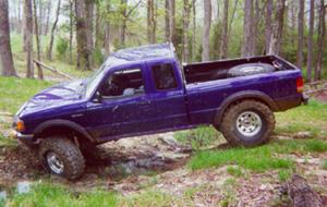

Dean Schimmenti's
1997 4X4
VEHICLE:
  • 1997 Ford Ranger SuperCab 4x4
ENGINE:
  • 3.0L-V6
  • Custom air intake w/ K&N filter
  • Stock 5-speed manual transmission
  • and Borg-Warner 13-54 x-case
AXLES-FRONT:
  • Stock Dana 35 reverse with disc brakes,
  • Manual locking hubs, SKF bearings,
  • 4:56 Precision gears, and Lock-Right locker
REAR:
  • Swapped in Ford 8.8, (NOT SHOWN IN PICTURES)
  • Moser 31 spline axle shafts, Timken bearings,
  • 4:56 Precision gears, Detroit locker, and a
  • Summit Racing heavy duty aluminum diff cover
SUSPENSION:
  • Superlift 4" suspension kit with Coils up front with extended radius arms, and an add-a-leaf in the rear.
  • 3" body lift with bumper brackets
TIRES & WHEELS:
  • (5) 36"x14.50" Super Swamper TSL Radials on 15x10 Eagle Alloy 58 polished aluminum rims,
  • Note: some major fender trimming was required to run the big meats and keep a lower center of gravity, but still get the articulation I wanted.
BODY ARMOR:
  • Stock skid plates
  • Custom rock rails made from 2x4 box steel
  • Rear shock mount skid plates
  • Rear diff skid plate (NOT SHOWN IN PICTURES)
  • Herculined bed with soft tonneu cover
INTERIOR:
Basically stock except for:
  • Custom lockable tool boxes behind seats,
  • Sony 10 disc CD changer with stock stereo
  • CB with extra speaker
  • Hand throttle on shifter
  • Seat covers
BUMPERS, RECOVERY EQUIPMENT, and SPARE PARTS:
  • Warn Trans4mer grill guard housing a XD9000i winch, 2 KC Daylighters, and 2 tow hooks
  • Stock tin can bumper and 2 tow hooks on frame
  • Original spare tire (for extreme emergency use only), Tow straps, chains, tree saver, clevis hooks, shovel, Hi-Lift jack, 2 floor jacks, First-Aid kits, spare axles, U-joints, tools and much, much more.
FUTURE ADDITIONS:
  • Exterior roll cage, junk the front IFS for a Ford 9" straight axle, with an ARB Air Locker with braided lines, on-board air compressor, Cut-out doors, heavy duty drive shafts, pre-runner style bumpers front and rear, and hopefully someday swap in a 5.0L V8.
  • After that, I think I'm done. Right!? Oh yeah. Favorite stomping grounds: Tellico, Uwharrie National Forest, both in North Carolina, and the Pine Barrens in New Jersey, where I used to live.
