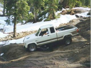

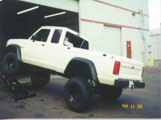

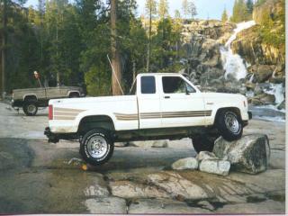

ENGINE:
K&N Super filter, Splitfire plugs and wires... the 2.9 breathes through custom pipes to a 3" Flowmaster turndown before the rear axle.
REAR AXLE:
4.56 gears w/ a custom Trac-Lock posi... we took a pinion from a Dana 38 slammed it in for the length and then stuffed a couple more clutch pads on.
FRONT AXLE:
4.56 gears with a Lock-Right Locker.
SUSPENSION:
Superlift 5.5" lift including new rear springs (NOT BLOCKS), new front coils, extended radius arms, Superlift steering kit, and Four Wheel Parts Wholesalers "El-Cheapo" shocks.
SHOES:
15X10 Black Rock Crawlers wrapped in 33X12.50X15 BFGoodrich Mud-Terrains.
STEREO:
Kenwood head unit, Lanzar 5.25 3-ways in the front dash, Pioneer 2-way fills in the rear, an ORION Black Series amp leading to an Audio Art 10" sub in a custom sealed enclosure.
