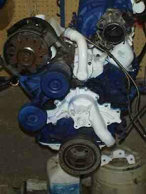

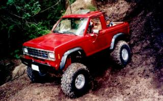

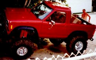

This is my Bronco II.
It has a 4.0L engine.
The tires are 38.5 x 14.5 x 15in Super Swamper SX's, and to fit these monsters under my truck I used a 3in body lift and an 8in Skyjacker lift. And since that still wasn't enough I had to put Bushwacker cutout fender flares.  Axles are equipped with 4.56 gearing. The rear is locked with a lock- right locker.
