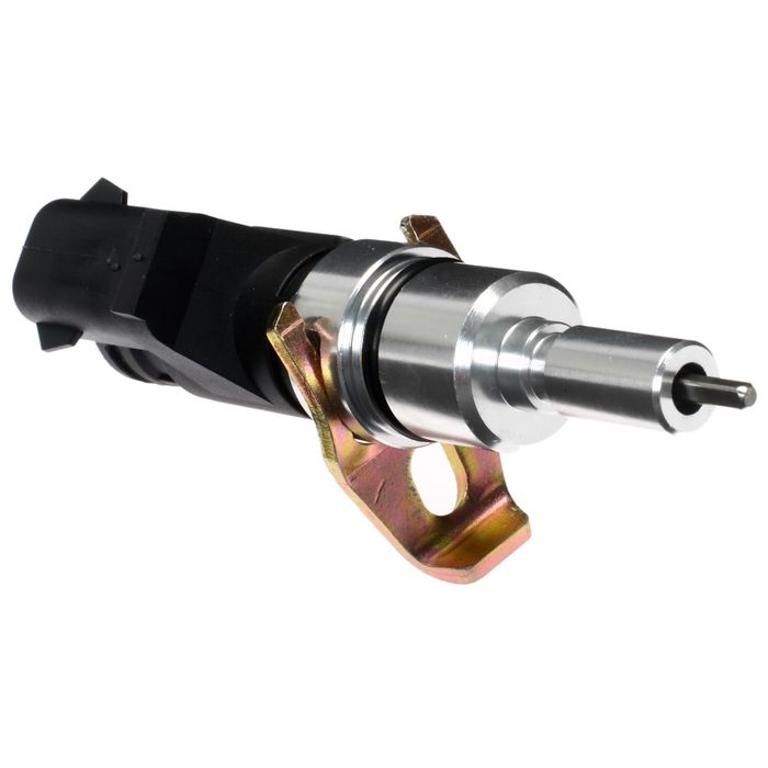

AOD/transfercase setup should have speedometer cable hookup which can be used with the later model cable/VSS Ford setups from the early 1990s, for electronic speedometer.
These were 8,000PPM setups so no conversion would be required just changing the Driven Gear for tire size and axle ratio was the adjustment for True Speed
They look like this: http://contentinfo.autozone.com/znetcs/product-info/en/US/wl2/SU1019/image/8/
You will need to run the wiring for it, since 2003 stock VSS/OSS wiring will have gone to computer first and then out to Speedometer
VSS generate their own AC voltage so no power is required
