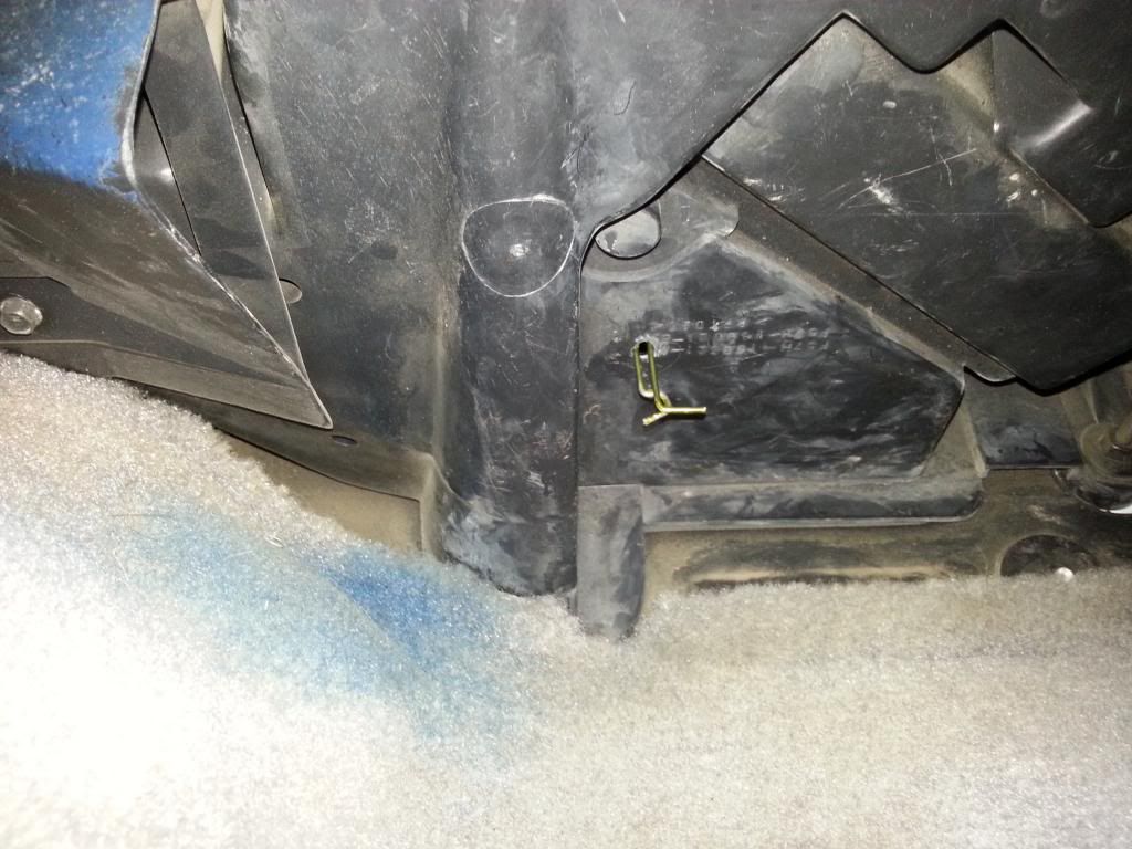

Climb under the dash so you can look up at the heater box. There's a triangle molded into the bottom of the heater plenum that the door swings in, with the door axle recess at one of the corners.
By looking at the axle and figuring the door (at its bottom seal) is about 1/2" wide, I figured out where to drill a 1/4" hole that would be just "outside" the door. See the picture.
I used a 1/4" shorty pilot bit out of a hole saw because that's what I had handy, but it turned out to be ideal. Drill the hole about where you see it in the picture.
Then I made a sort of a "bobby pin" out of coat hanger wire from the office closet - it's got a little u-bend in it to allow it to "snap" into place, and bends at the bottom to keep it from going all the way in. See the photo, and imagine that about 1/2" up into the hole it's bent double.
After taking the picture, I crammed the wire pin up into the hole so it locked in place.
Basically the wire is bent so that it can be inserted up into the hole, blocking the door from falling out of the "Hot" position, and snap into place. This holds the heat full on until I have a nice day to apply a permanent fix. I applied this "hack" in the parking lot of my job in 15 min, including figuring it out.
