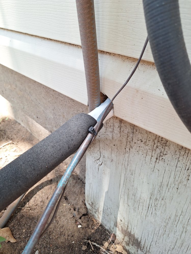

It's 101 degrees outside and this line between my house and the A/C unit has a bunch of frost on it. How the hell is that even possible???
Typically that would indicate the system is low on refrigerant.
When the high speed on our blower motor went out earlier this year ours did the same thing.
According to the internet, it looks like I'm low on freon. I had them put some in last year and they told me I might have a small leak somewhere.
The unit outside is 2-years old. No idea how old the coil is in the unit inside.
I wouldn't sweat it, it will quit leaking eventually on its own. Then as an added perk the line won't freeze up any more either.
yeah low freon.. I have also seen a stuck contactor that would not release on the outside unit causing that. the thermostat tells it to shut off and the inside unit obeys, but the outside unit just keeps on chugging away because it can't turn off..
but in light of your previous freon top off, I am going with the leak option

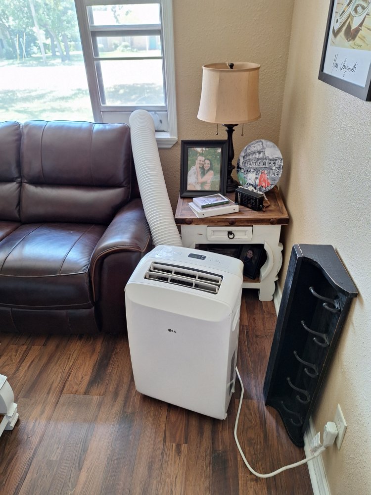

I shut the house AC off to thaw and turned on the ceiling fans and this portable unit. I sent a message to the AC guy.
