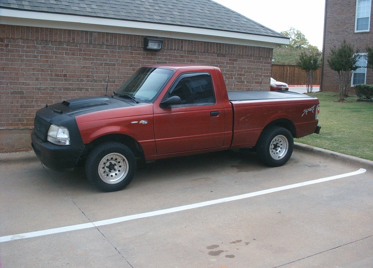

I've never had a vehicle with torsion bars, so I can't say. I love the way my 98 3.0 V-6 Ranger runs and handles. It's not lowered, it's a SPORT version. I did fit it with Hellwig anti-swaybars back in 2002, two years after I bought it. And put all new suspension bushing on them in 2015, the originals were shot. Rolling on 205/70-15s up front and 255/60-15s in the b ack. Goes around corners like a slot car on a track. Have some new rims and tires making an appearance Sunday evening. Front's are 215/60-14 on 14 x 7 rims, rears are 235/50-14 on 14 x 8.5 rims. Nice staggered arrangement with some fairly fat tires. Will be replacing the rears with BF Goodrich TA Radials in 245/60-14, to keep near the 26 inch diameter I have now.

That's one nice looking Ranger. The reg cabs certainly drive and handle nice, just as well as cars, maybe even better. The wheel base is the same.
Ranger reg cabs are also light. I believe that mine weighs in just over 3,000 pounds, less than a Mustang, or a mid price Buick. Didn't yours come with sway bars? Or were those Hellwigs an upgrade?

Mine only had the front bar when purchased. So yes, they were an upgrade, and worth every penny.
