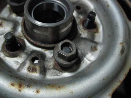

Is this not enough thread through the lugs? They're finger tight.

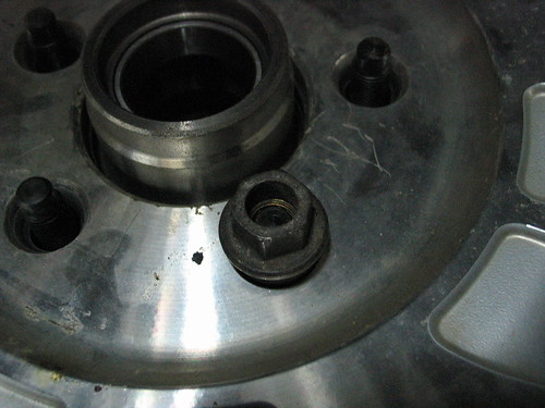

Stock steel spare for comparison:
I pretty much have to use the alloy deer hooves in the first pic. I'm ditching the 2.5" lift on my truck and the 31" tires and my Cragers won't work with the 2" drop coils I just installed. If that first pic looks unsafe to you (again, just finger tight in the pic) what are my options? Extended thread lugs? Longer wheel studs?

you can easily get longer studs but it looks like plenty from what i can see.
looks like in the pic the stud is all the way through the treads of the nut if so you got no problem at all
There are still like 2 threads showing in the first pic but there's still about 5 rotations of the lug worth of stud thread in there.
how many threads actually engage? how many turns?
I would run it down tight and then look at it. If all the threads of the nut are engaged you won't get any better grab so it doesn't matter.
I just checked again and I get about 9.5 or 10 lug rotations. I tightened it down pretty tight with a wrench and it still looks about the same as the photo above. Dang!
I guess when I'm finished with the front end work I could just tighten them to spec (like 100 ft lbs I think) and hopefully that will be safe enough to get me out of dude's garage and back home. In the meantime I could order some extended thread lugs (Gorilla brand or something) and see if those get me some more threads to bite on. 2 local auto parts stores had nothing like that.
Whaddya think?
ten is probably about bare minimum IMO, would like to see more like 15. probably would get you home just fine, but wouldnt be ideal. just my humble opinion.

10 threads is about 1/2", 15 would be about 3/4". ideally length of thread engagement would be 1.5x diameter or more, but 1x will probably get you by.
on a side note, those wheels arent getting caught up on the hub, are they?
That's a good thought Kunar but I can feel the back of the wheel meetin the hub mounting surface with my finger and the meet right up. This is a weird predicament right?
It's not that wierd. Those wheels are just thicker. I think those are the correct lug nuts though.
