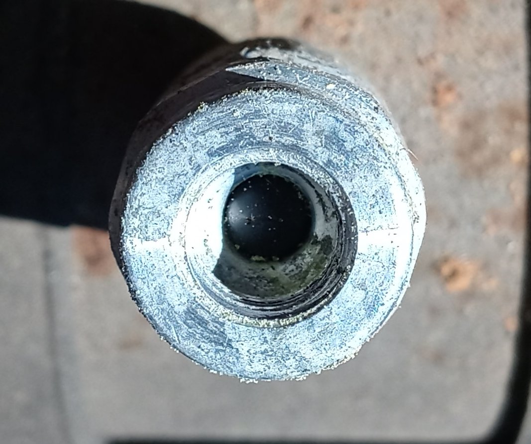

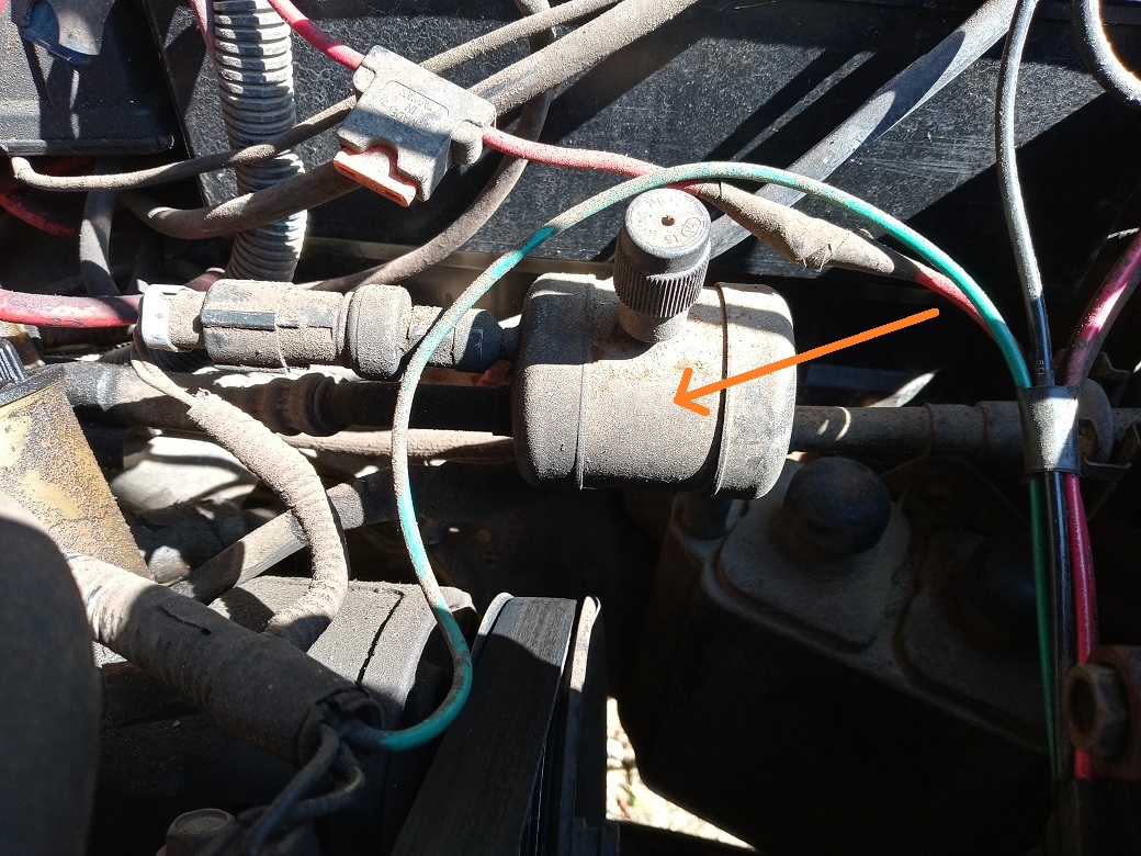

What's this AC component? I want to buy a new one but I've searched everywhere and no clue what it is. 1997 Ranger 3.0
I think the valve is leaking. It looks like a rubber ball instead of a schrader valve.
It's called a "muffler" and is part of the hose assembly.

So how do I get a new one or at least get a hose with a new valve? Also need a place to plug in the high side pressure switch. What part do I buy?

That's the evaporator to compressor hose, or suction hose. Go on a good parts website, like RockAuto, to punch in the info and drill through to get an idea of what's available, at what prices; and you should be seeing pictures which you can compare to what you're lookin at in the truck.
A new receiver/dryer is good idea, but that's your call.

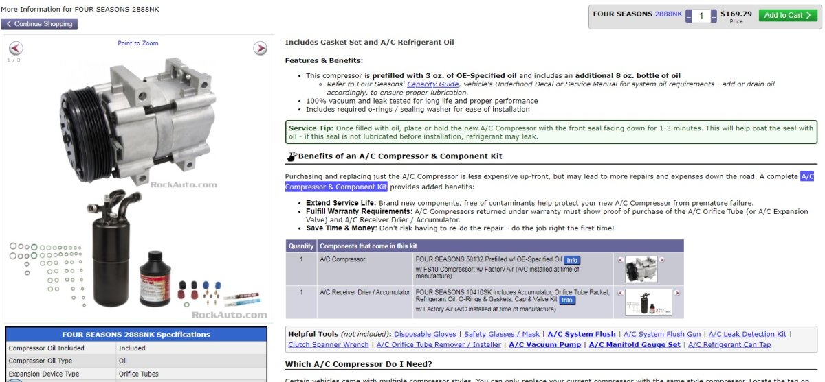

Yep, that's what I did. I was going to get this kit, mainly because it had both a red and a blue whatever those tube things are called, but I didn't see anything that looked like that "muffler".

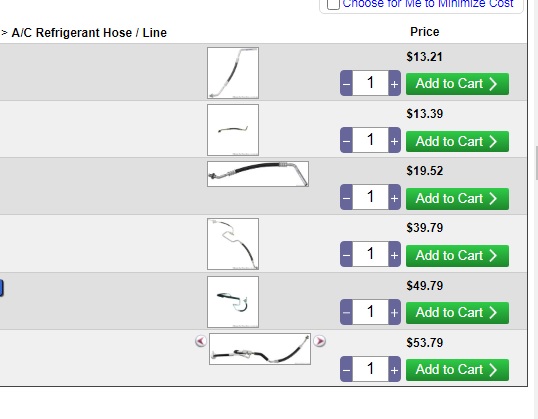

None of the hoses seem to have the schrader valve or place to plug in the switch, unless it's the last one for $53.79. But the pic isn't very clear so I'm not sure.
Yeah the last one might be it. What do you think?
It says "w/ muffler" and "w/ service port".
That's it.
That's it.

I'm reading about the red vs blue now. I guess the blue has a bigger hole and less likely to create a bottleneck and stress the compressor. But I don't know what mine has in it now so that's why I was wanting the kit with both.
