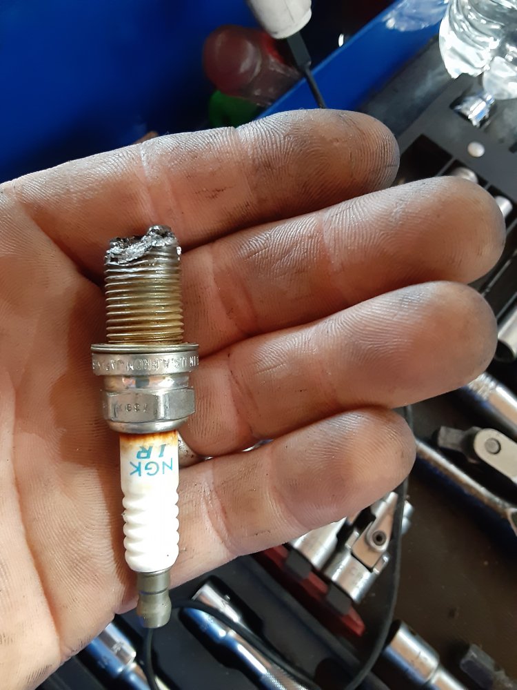

Iridium plugs melt.... all 4 plugs were melted, number 4 cylinder gave out first and impacted this one... this is a k24a4 I had in my shop today. customer said they needed a starter, they need a motor. So I'll stick with my coppers! Lol

If janitor doesnt take my bin out tonight I can get a pic of other 3.. cars may be designed to use certain plugs BUT that's for emission and mpg ratings not longevity. Also why so many parts are made of plastic... light weight, cheap, and require less skilled workers to make... I've changed more cracked plastic water housings on bmw, vw, mercedes and modern domestics then I ever have an old steel one for rusting out. Except chevy 350 water outlets they always seem to warp!
