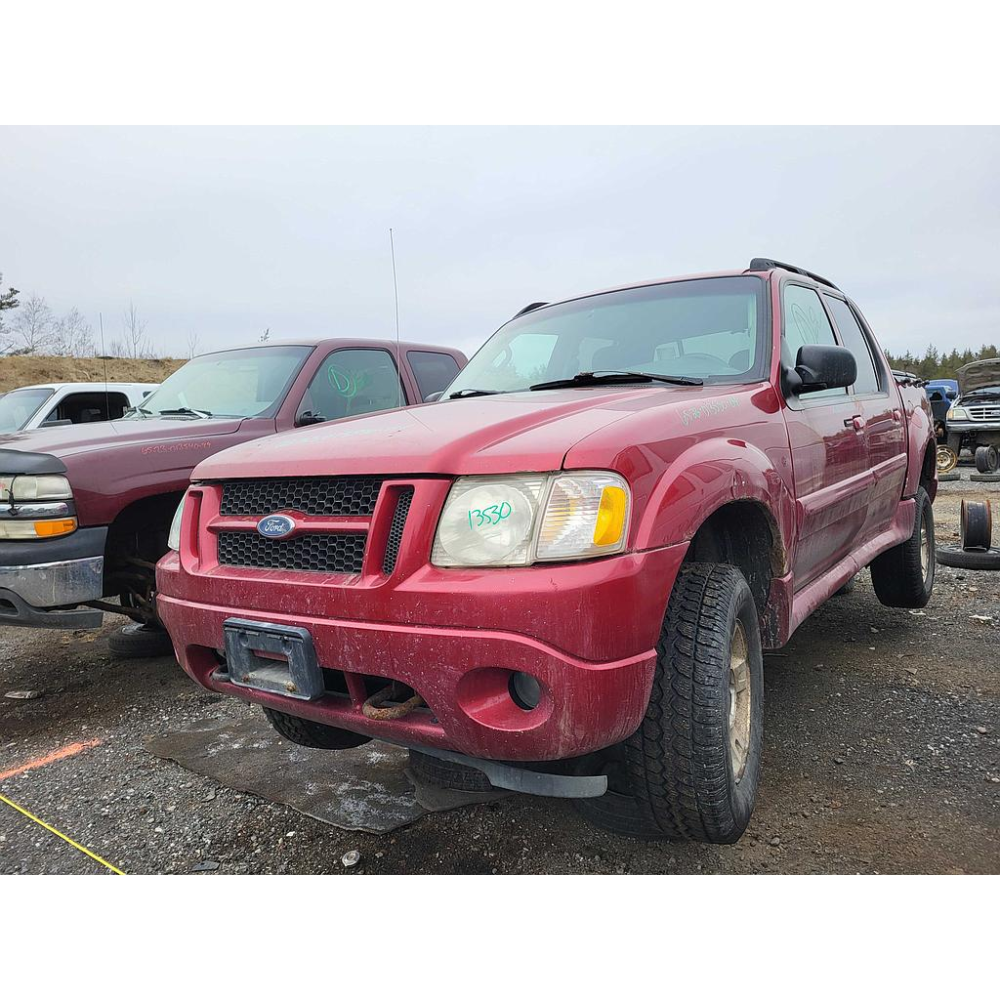

  1. 2004 Explorer Sport Trac, 4WD, 4.0 V6 XLS. It actually looks pretty clean, it's been on the pick and pull lot for 3 months now however so it's probably not entirely complete.

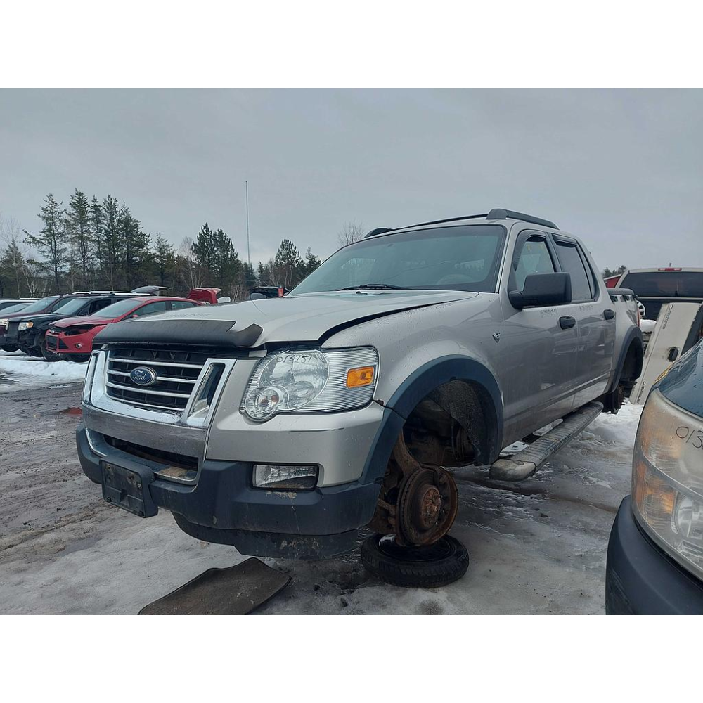

  2. 2007 Explorer Sport Trac, 4WD, 4.6 V8 XLT. Again, looks pretty clean, can't quite see any crash damage from online pictures.

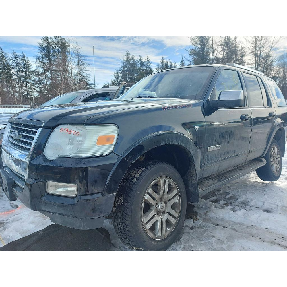

  3. 2007 Explorer, 4WD, 4.6 V8 LIMITED. I think there's a rear impact on the passenger side, but again, can't quite tell why this thing's at the yard just from the photos.
