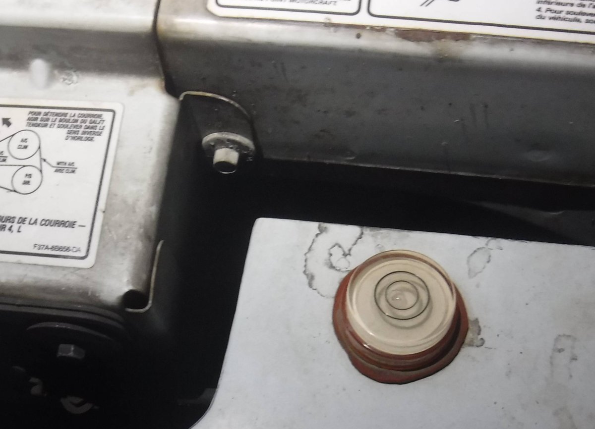

Just put the level on the sides of the bed, across the radiator support, across the bed behind the cab and again on the tailgate part of the bed. Anywhere you can find a solid point and a straight line
Got the bubble levels from Sears store for maybe a buck apiece and used the red silicone due to it's location
